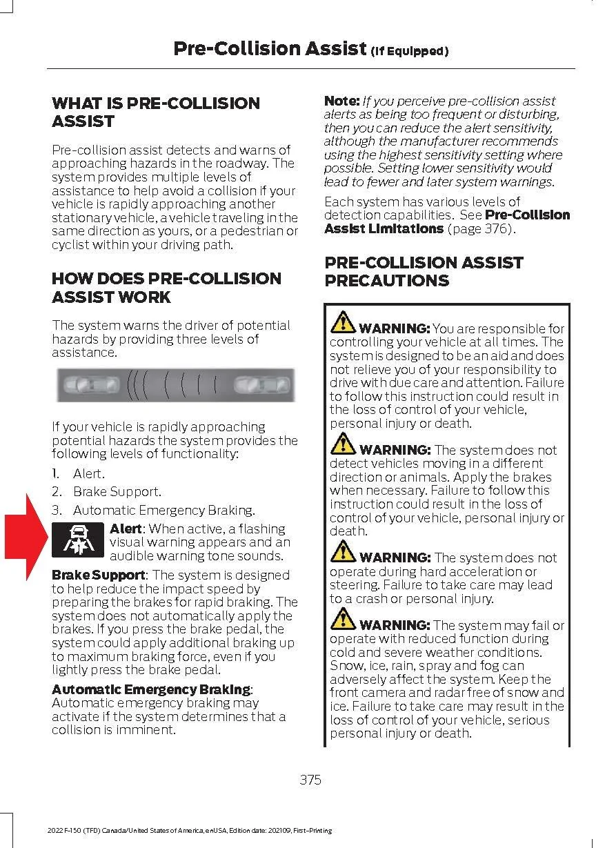

I think that’s for the pre-collision assist, letting you know that the camera is dirty or obscured and the truck can’t auto-brake in an emergency.

That's the Pre-Collision Assist system icon, apparently showing disabled status for some reason (?).
Ford F-150 What’s this warning lamp? PRE-COLLISION ASSIST SYMBOL

Interesting, I have a base tremor and no 360 package so no camera lens’s on the front or side mirrors? Just the tailgate?
Might be that the radar module behind the grill is 'blocked'.
