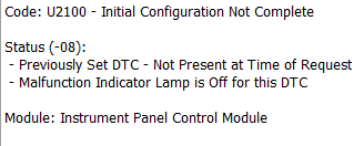

Looking to get some help here I have a bit of FORScan experience previously but these 21+ F-150s just have a ton of modules. I bought a 21 F150 Platinum that is now out of the bumper to bumper warranty that seems to be throwing a U-2100 DTC on the UPC. I don't know the history of the truck and don't have a backup from FORScan prior to this error.
I see recommendations for fixes such as PMI using FDRS, am I going to need to get my hands on a Mongoose cable and FDRS license to resolve this?
Edit : Resolved documenting procedure so if others find this, hopefully it doesn't come back
Source : http://blog.vxdiagshop.com/2022/12/22/ford-f150-u-2100-initial-configuration-not-complete-solution/
