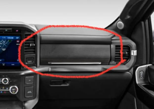

When I press the open button nothing happens. I have to press in the button and manually pop to door open. Any others experience this? I will probably have the dealer look at it next time I have it in but was curious if you all had experienced similar issues.
I actually just had this fixed under warranty. I rarely open the upper glove box but found that it wouldn't open when pushing the button. My dealer said that after they removed the latch assembly that something internally broke because there was something rattling in it.
Here is my paperwork that shows the parts that they replaced
