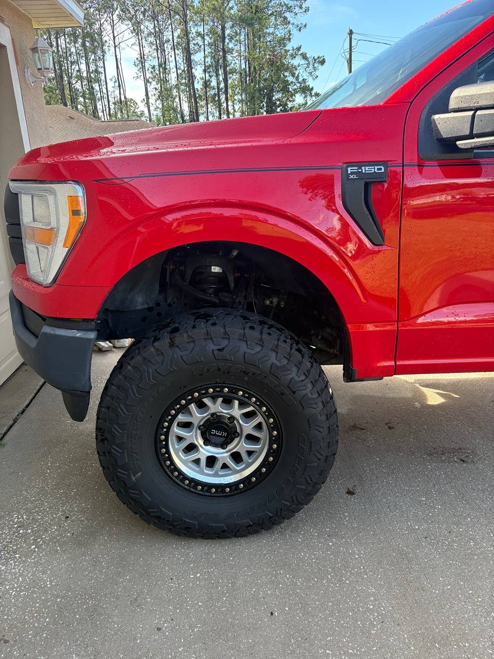

So I installed this maxtrac 6.5/4 inch lift (2.5 inch level pick with 4 inch spindles) on my 2022 2wd f150 around 5,000 miles ago and I was wondering if any of you guys had any recommendations on what I could do to fix my upper control arm angle. As you can see In the photos my angles aren’t the best but some how the spindle and control arm don’t hit the coil over at all. The only ideas I have are to some how find bigger spindles or just lower the front a little (which I would rather not do). I appreciate any ideas that you guys have.

looking to do the exact same setup you have on my 2wd. is the driveability on that still okay and do you have to chase it down the road.
also the only way to fix the angles would be to get different upper control arms.
