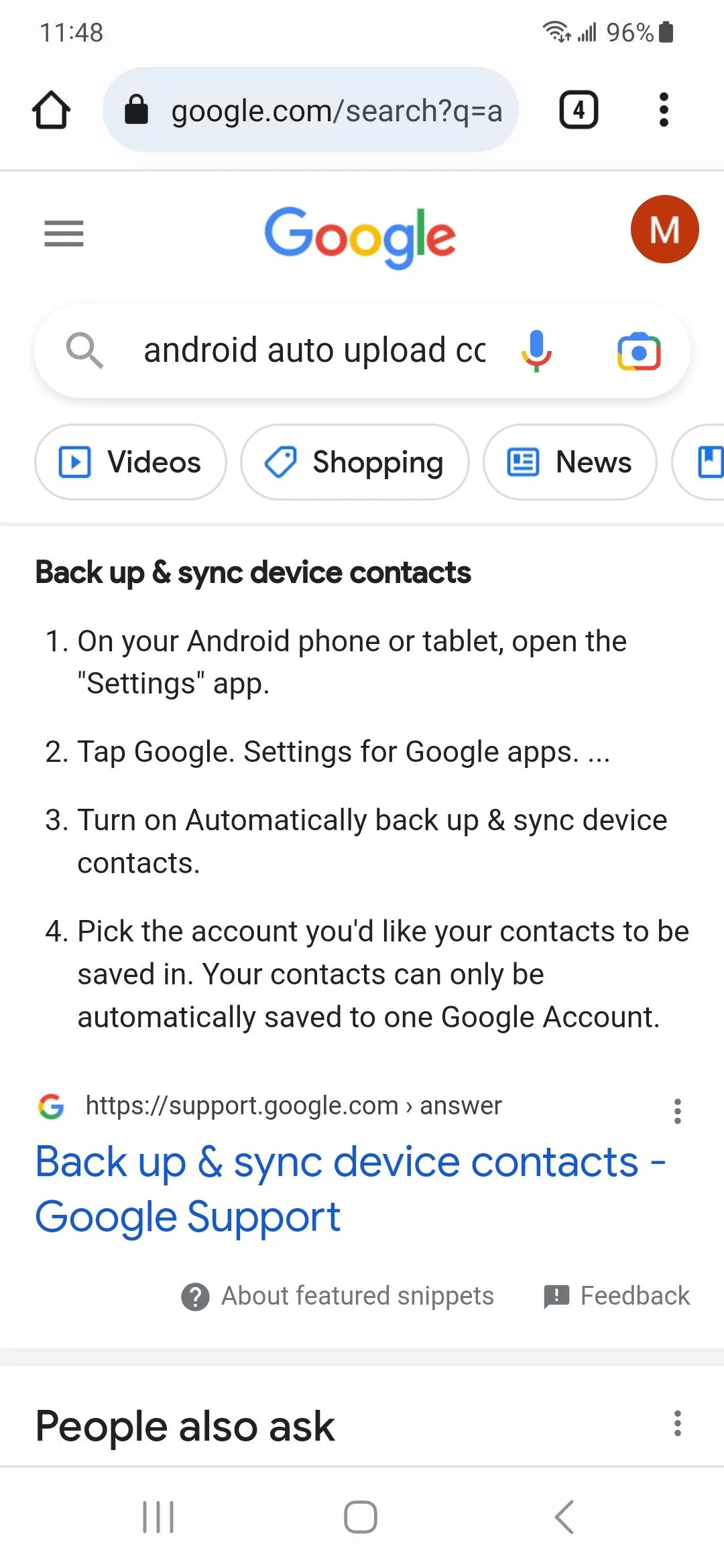

Check your phone settings, contacts need to be shared with other devices.

Ford F-150 Upload contacts? Not sending messages 16845020388541331316837910050966
fordtruckman2003
Apr 28, 2023
4,587
3,746
Indy
2021 F-150 FX4 Lariat
Well that's an odd place to hide it.
Figured since I can say "call <contact name>" and it would call them, and I can see the dang contacts on another screen that it would not need another setting...
Thanks!
