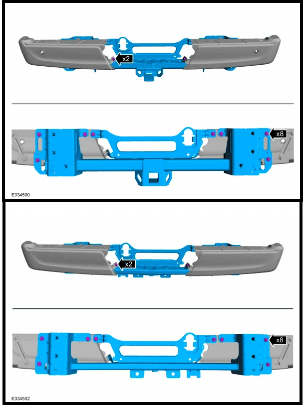

The standard Ford Class IV hitch is HL3A-19D534-AC which is rated for a WD hitch load of 11,600 lbs. This becomes the limiting factor for the trucks.
