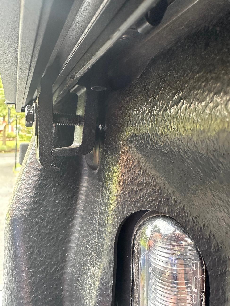

It doesn't look like the clips are sitting in the rail correctly. They should be 90 degrees to the rail.

Thanks for the pictures I think I’m gonna have to try again now lol ?
Is that clamp sitting completely above that lip on the rail.

That is correct. The clip goes in at an angle and then you push on it to lock it into place on the rail.

I'm sorry that you're having trouble getting this installed! @RyanW good eye catching those clamps. What you may need is an extra set of hands to pull on the tonneau rails from the outside of the bed, flush to the bed, while you're installing the clamps.

Thanks man I appreciate the extra set of eyes and comments. I just got installed correctly and wow much easier once I got those clips set in there correctly.
