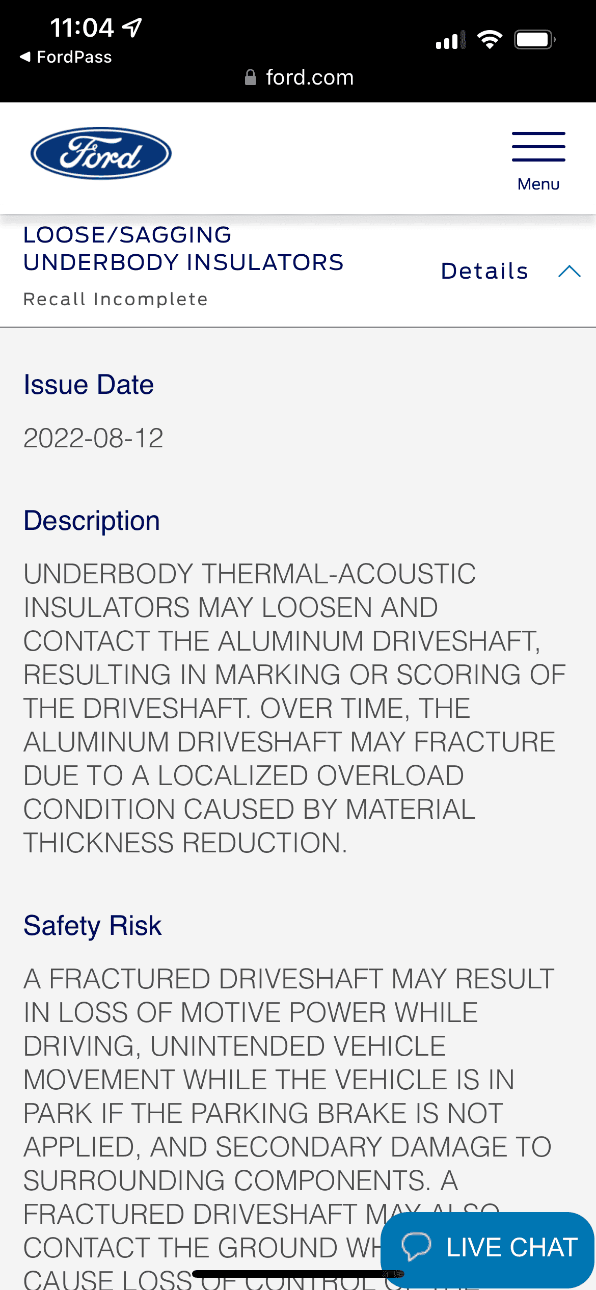

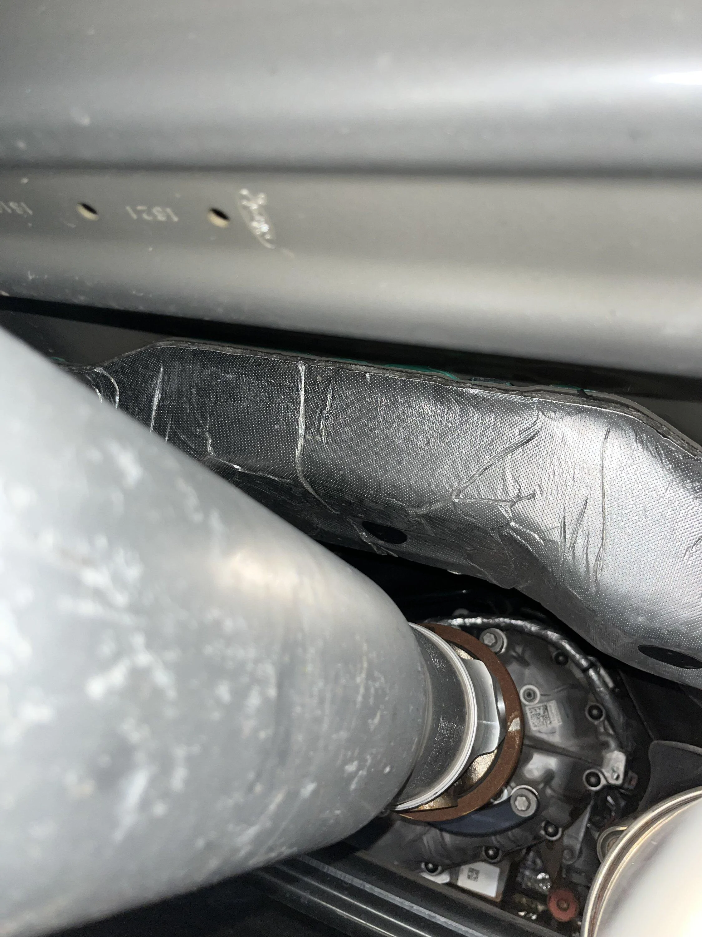

Just got this this morning for my 2021 XLT 301A. 301A was excluded from the previous recall. Look OK so far after 15 months.
Ford F-150 Underbody insulator recall expanded IMG_3821

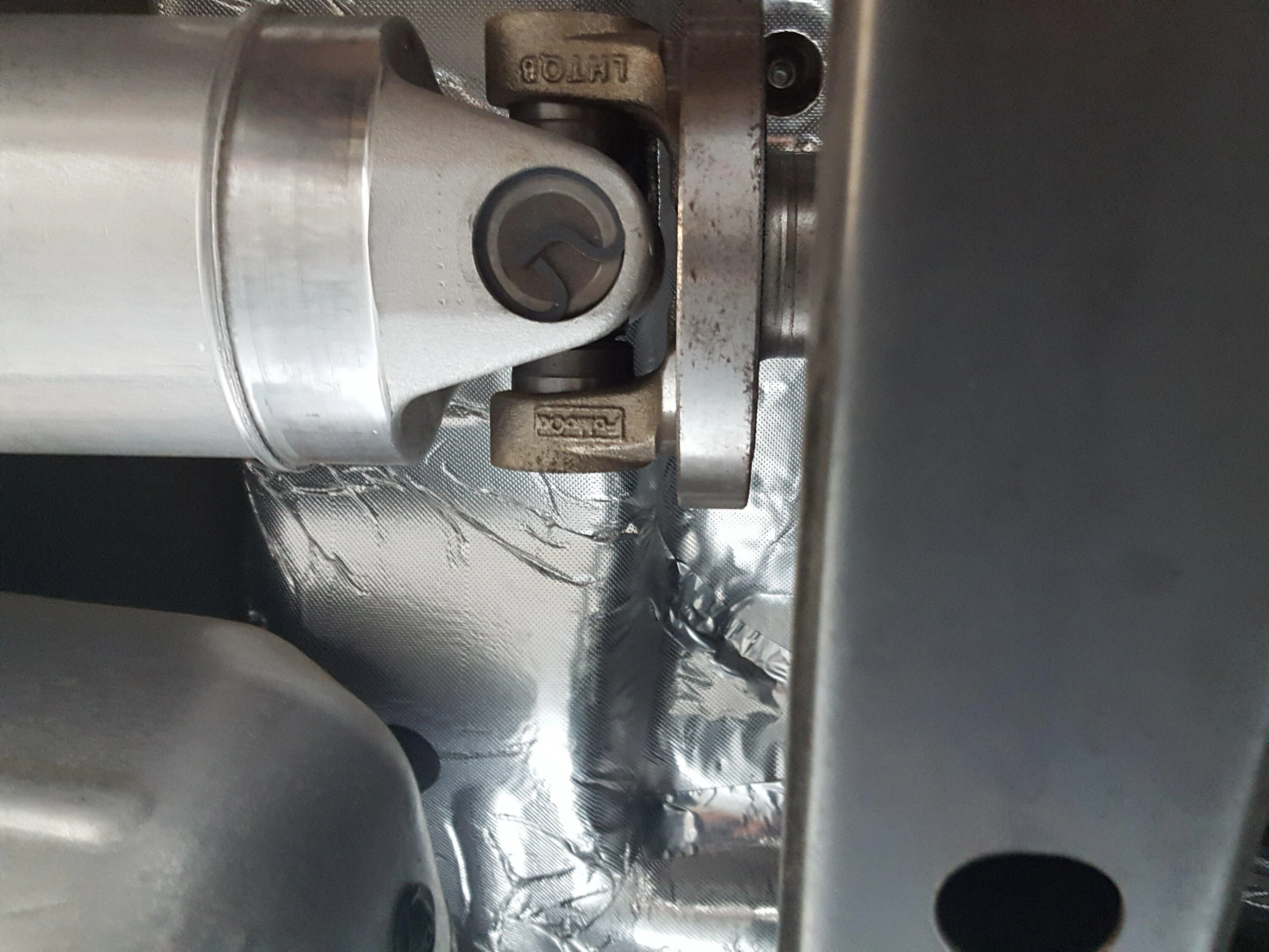

mine looks ok.
but...
i was thinking about some adhesive to supplement the plastic tabs
Ford F-150 Underbody insulator recall expanded driveshaft (11)
