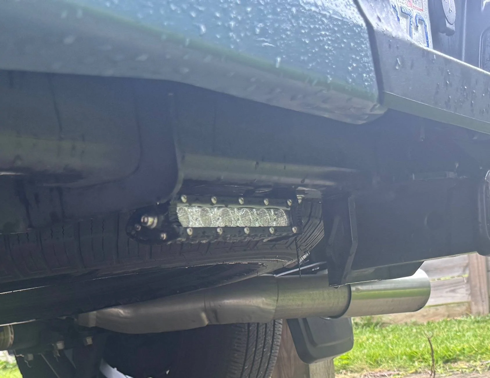

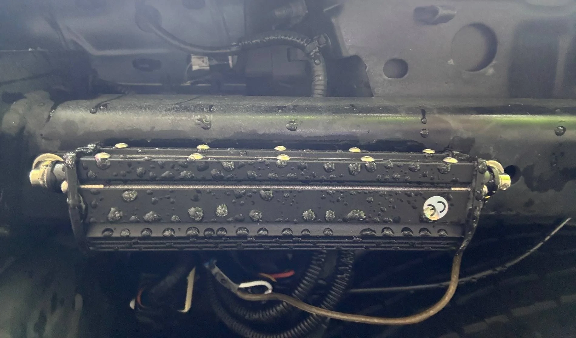

I drilled and tapped four holes in the trailer hitch bar for 1/4-20 bolts. I bought an adapter on Amazon that gave me the reverse wire behind the bumper trailer plug. Looking forward to see how they look at night.

Would love to see some pics of the actual mounting place / design and link to the adapter on Amazon.

How does your back up camera look at night, do the lights wash out the camera?
It is not washed out. The lights are only 30 watts. I have only seen them in the driveway so far, but are not too bright. I wish I had angled them out just a few degrees. After I have used them for a while, if I need to aim them different, I might move them.
