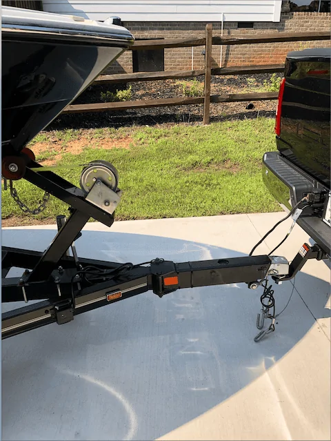

2021 XLT 302a truck, came with the now-famous Pro Trailer Backup Assist sensor and install kit. I've installed it, but during trailer setup I get stopped with a message about System is not available. I've checked and re-seated the trailer cable connectors and even the back side of the bumper connector.
I've searched and could not find anyone with an answer to why this happens.
Ford F-150 Truck has Towing Tech package, came with PTBA sensor, but shows System is not available pbta_not_avail
And here shows where I've mounted the sensor:
Ford F-150 Truck has Towing Tech package, came with PTBA sensor, but shows System is not available ptba-sensor-location
Any idea to try would be very much appreciated :)

Finally got time to experiment with pro trailer backup assist again today and may have figured it out. I connected the sensor harness, put the truck in reverse, pushed the backup assist button on the dash, and noticed the center screen said "Reverse brake assist not available" or some such. I went into settings and reverse brake assist was indeed turned on, but I toggled it on and off. Now the Pro Trailer Backup assist recognizes my trailer and I no longer get System Is Not Available.
