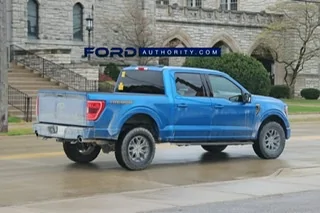

"we all see it - we all see it" The new "live" photos do show quite a rake, kinda confirming the few photos that circulated a month or so ago. I don't like it. I have an AT4 that came with a "2" factory lift" and it is quite level from the gate, and it is about the stance I will want my Tremor to have, should Ford ever bless me with a build date.
For those of you that want a level, what product are you considering? is a 2" level gonna make the tires look small? Is there a "just right" solution at 1". Is this like a $500 job if I have someone do it? just don't know much about level kits and know there are a lot of enthusiasts here -

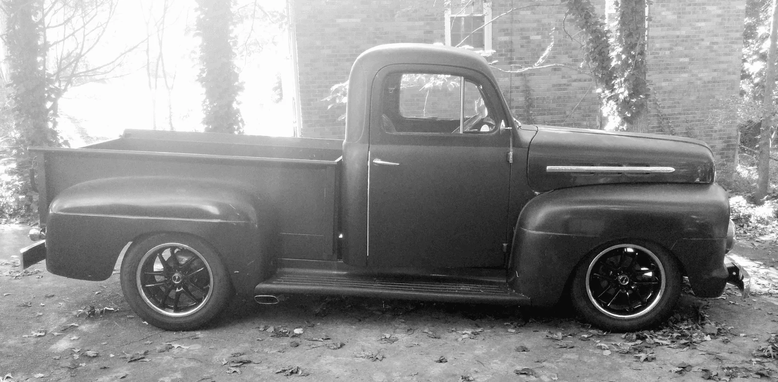

Maybe some extra lift blocks in the back and lowering coils in front to enhance the look :p
Ford F-150 Tremor Rake - We All See It 5BDB3B72-0AB7-45CA-B229-E18D09671B57
Ford F-150 Tremor Rake - We All See It 918941B0-56B0-4838-BD54-1FBF48C29293
So far, I haven't seen a single one of the car review shills say anything about the preposterous amount of rake on the F-150 Tremor. Yet pretty much every forum has people asking about leveling kits.

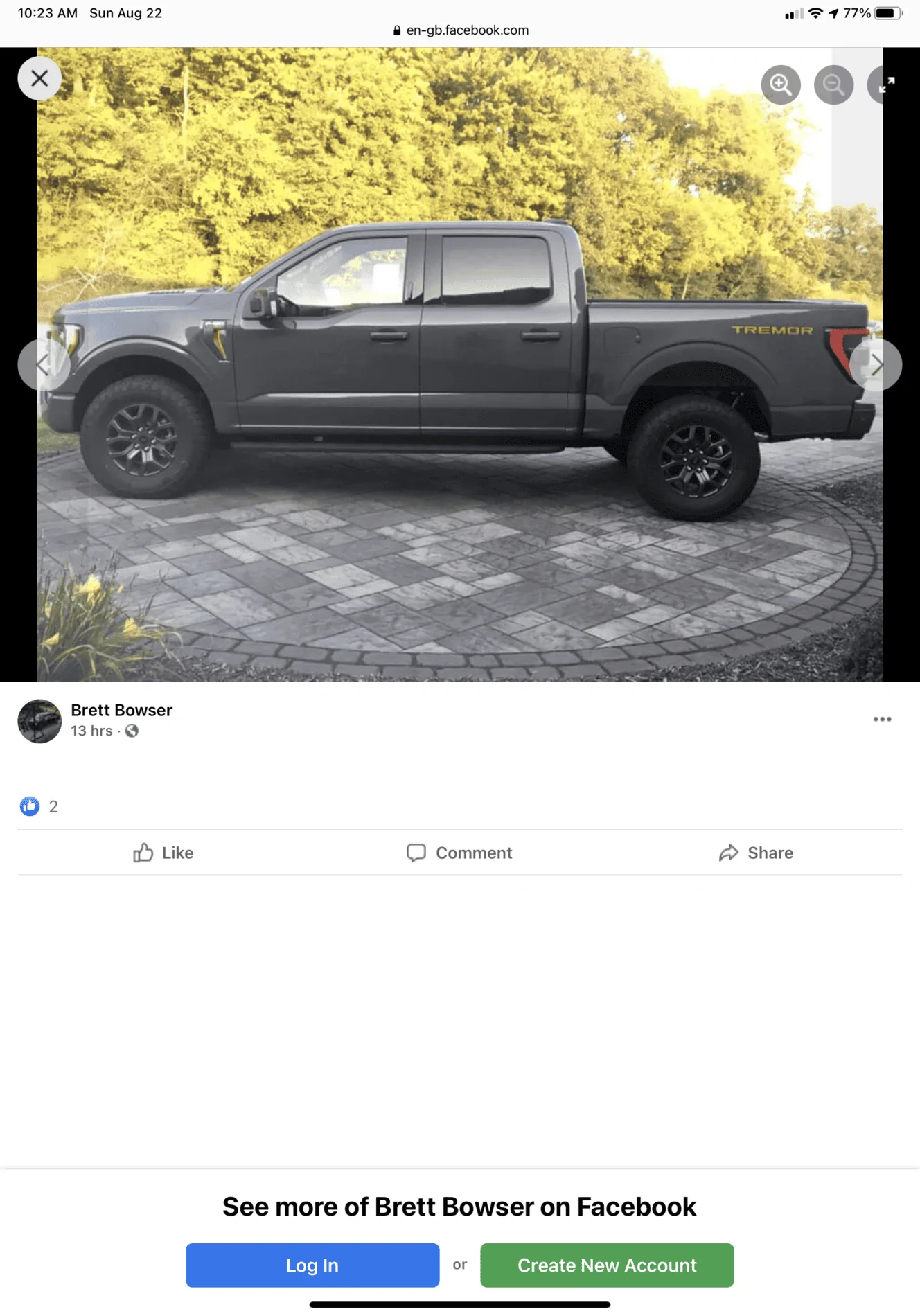

Here’s a questions for you guys..Someone just posted this on another thread in here taken from a facebook group. In this picture the rake and space in the rear wheel well appear much less unless it’s just a trick on the eye with the color of this truck. I believe someone had mentioned that the trailer tow/ max tow package will add more rake for that increased towing limit. Is that true? Maybe it’s just me, but some of the other photos seem to have more pronounced rake than this.
Looks to me like this photo is angled in a way where the two wheels are not parallel and thus mitigates the rake. The truck will definitely have a rake on it but I dont think the trailer tow package will make it any more significant since there is no spring upgrade that comes with trailer tow pkg.
Awesome, thanks!
