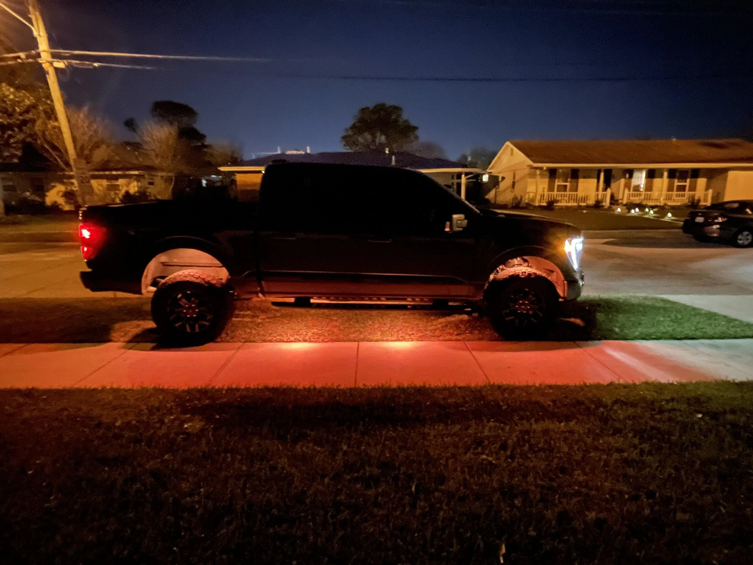

This looks sweet man. More details and pics pls.
Xprite Wide Angle Bluetooth RGB LED Rock Lights Kit, Multicolor Neon Lighting Footwell Underglow Kits w/ Wireless Remote, Compatible Off-Road Trucks Cars UTV ATV SUV RZR Motorcycles Boats 8 PCS https://www.amazon.com/dp/B095WMMC5B/ref=cm_sw_r_cp_api_i_PY0DGX5JY1FPZHZE57QP?_encoding=UTF8&psc=1
went with 8 wide angle lights. 1 in each wheel well, two under each step. Ran the wires through the truck frame with fishing tape and hooked it up to aux 6. Needed one extra extender, but two is suggested to reach wheel wells but i made it work. Fun lights, different modes and can be controlled with app or remote. I’ll get some more pics in a bit. Attached in wheel wells with screws and attached under steps with outdoor tape and a super glue/silicone and feels solid. Easy project and I’d buy them again.
