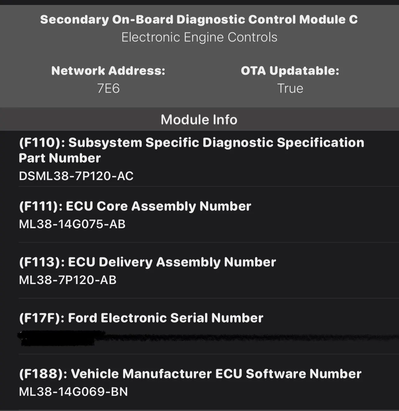

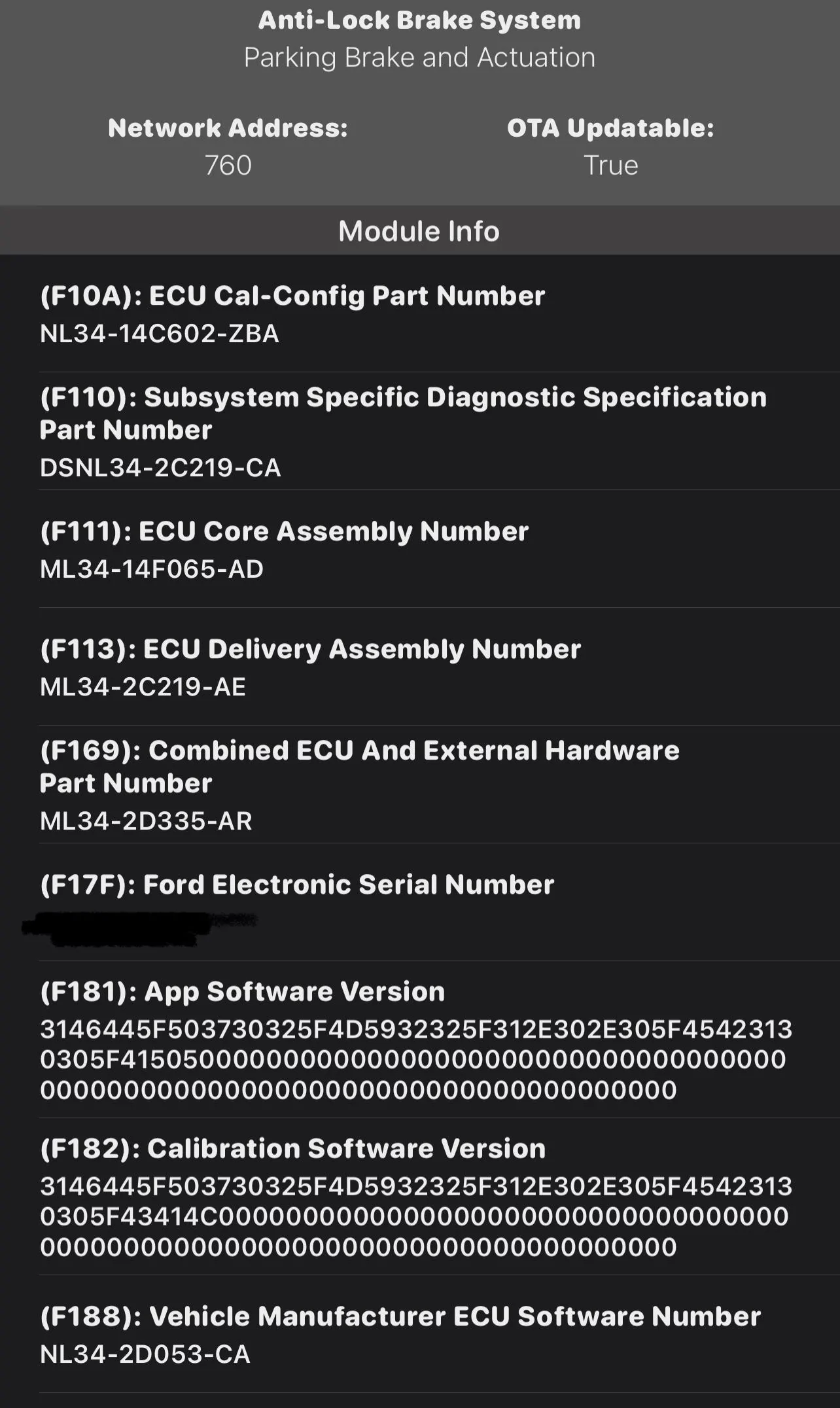

I got to take the truck on a trip over the weekend and I have had zero shuddering whatsoever. The truck got excellent milage and ran like a top. The ride was the same route (lots of hills) that the truck shuddered terribly on my last trip before the re-flash was done. When looking at the TSB it looks like for the Powerboost there are multiple modules that require updating. I accessed the software versions using scriptable FordPass app and I took notice that the software versions did in fact change. I am going to attach pictures of my updated software versions so you can compare. I can’t help but wonder if they are not applying the updates properly, or not applying all needed updates. Also, If you read the TSB, it instructs the technician to test drive the vehicle and verify the shudder. If he does not feel the shudder, he is not to perform the update. I would read your work orders very carefully.
In my case I know for sure all of my modules weren’t updated. I have to bring it back at a later point to have it serviced again. My dealer is having issues with whatever systems they use to update the software and is having a field service engineer come out to assist with updating their systems. Still hope on my end. I’m wondering if the fix they tried was just resetting the tranny tables as my shuddering was almost non existent after running 93 fuel for a few months. Still have my fingers crossed
