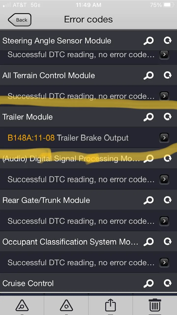

Additionally see screenshot from Forscan Lite indicating Trailer Brake output "short to ground". Cannot seem to find the date of occurrence anywhere, but highly likely AFTER it was evaluated by local dealer.

Ford F-150 "Trailer Wiring Fault" & "Trailer Disconnect" 2023-06-29 14.55.13 BlueDriver

The new thing is that in addition to "trailer wiring fault" (upon connection) I see "trailer disconnected" when pressing the BC tabs. "TWF" with functional brakes was the behavior until recently.
I will be taking my truck back to dealer tomorrow with the data gathered so as to get them focused on a potential solution.
The service tech notes from first visit indicated no related DTCs and that without assessing my trailer as well there was no means of diagnosing the fault... No way possible to get my trailer into their service area, also ignoring that there are expected outputs that can be evaluated to determine fault location.
Second visit (next day, due to dissatisfaction with another issue) shop foreman used a simulator and the lights come on as they should.
Given the low voltage when brake pedal and BC tabs are activated, it suggests the simulator is an insufficient diagnostic tool.
Given the B148A: 11-08 code I'll suggest they replace the connector.

GND - BC Output100 - 350 mVBrakes pedal not depressed; continuous variance within noted range; can be reasonably interpreted as shorting to GND consistent with B148A:11-08 Circuit Short to GND noted in Forscan error log
(occurred AFTER simulator assessment noted above)
Brake Pedal depressedExpected Value = 12 Volts
GND - BC Output6.5 Volts
Brake Gain adjustment activated
GND - BC Output8.5 Volts
Other
Ford Dealer Assessment 2Pending; Provided relevant Forscan log screenshots to Eddie RuizB148A:11-08 Circuit Short to GND; "Miles since DTCs cleared = 57"
