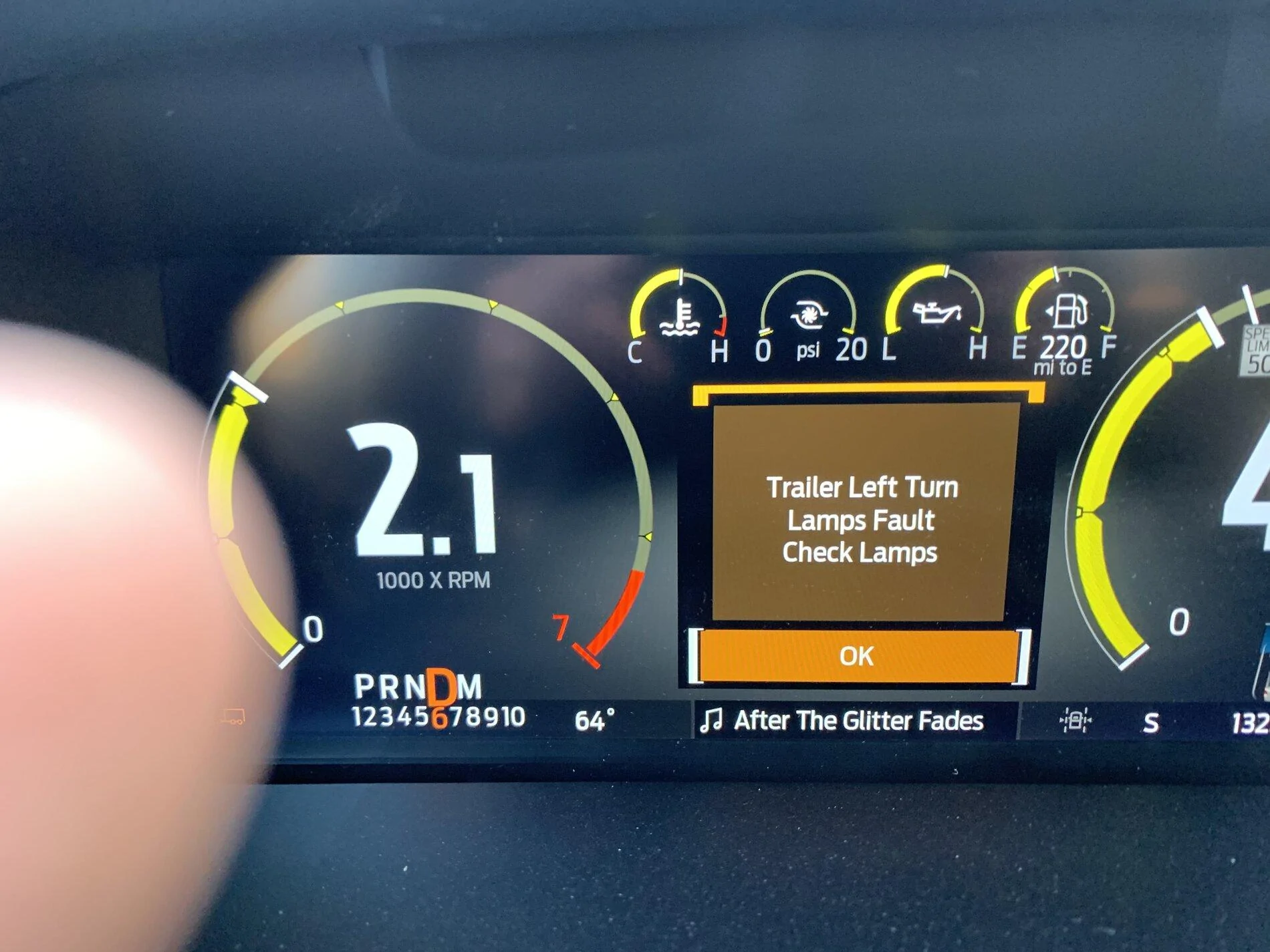

I have several issues towing my boat or a tandem utility trailer.
1) Left trailer turn/brake light failure constantly. If you turn on the left turn signal, flashes quickly a couple of time and starts working normally. Turn off left turn signal and fault comes back.

Posted a video of the same issue with the turn signal (mine is on the right signal) with my Airstream connected. I am going to try adding a resistor to my turn signal. Have read that the LED's don't draw enough load and the computer thinks the bulbs are out. Pretty common issue to folks that update their vehicle lights from regular to LED (they get the hyper flash and some cars provide a warning).
I also ordered a bypass (see link below) based on a recommendation from the trailer guy at my RV dealer. He send if all my electronics are working on the AS...which they are and you are getting the error it's probably this issue. Said this happens all the time to European cars that are used to tow trailers with LED lights.

Thanks for the link. LED trailer lights are not new technology and everything on my truck are LED's. I understand the issue and the link above and glad it will work for you, however, I am stilling to hold FORD accountable. If the issue is LED Bulbs, wouldn't both sides of the trailer send the warning? Yours is right side, mine is left side.

Just curious...Do your trailers have LED turn signals, brake lights, etc.?
I'm betting if I add the resistor to the right the left one will give the error next. The fact that the Airstream lights and turn signals all work fine tells me Ford could go the extra mile and program an option that lets owners permanently turn off that error for cases like this.
I can see Ford saying it's not them it's the trailer in my case...or say we can't plan for every type of trailer's electrical configuration. My sales guys and the service person I dealt with gave me standard answers (check the ground on your trailer connection, clean your connector, etc.). Which it could have been but not in my case...so you can only go so far with the dealership... the workaround is doable on my end. I'll report back to see if it solves my issue.
Both trailers I have tried have LED tail lights as most new trailers do. That is what puzzles me about Ford not being able to get this right.
I posted in another thread and solved the issue by installing a resistor on the right turn led. No issues since. Wasn’t getting anywhere with dealer or airstream service.
