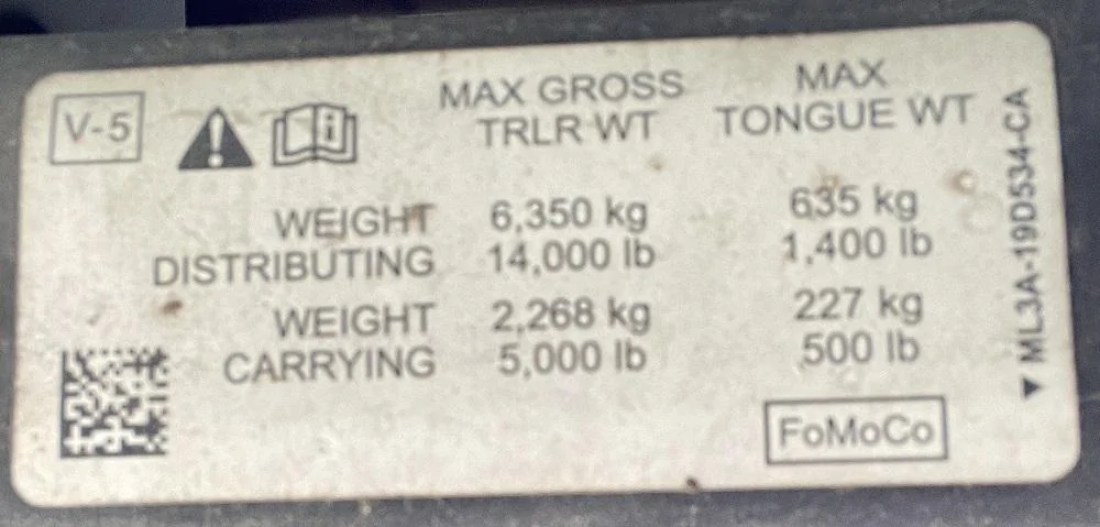

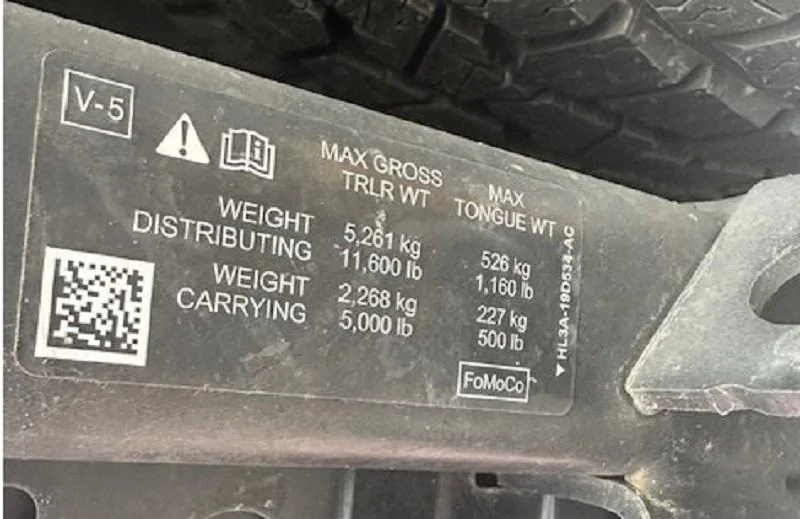

Examples of two on Gen 14s from a recent thread, PNs are visible
Ford F-150 Trailer Hitch Receiver part number RECEIVER STICKER
Ford F-150 Trailer Hitch Receiver part number TOW

Examples of two from a recent thread, PNs are visible
The top one is typically found on Max tow pkg, while the other is standard tow pkg.

Thanks, is the vertical value on right the Ford Parts number?
Yes.
Top is my 2022 Lariat with Max Tow, bottom is a 2021 PB with unknown tow package.

Thanks. Interesting that they rated the max weight carrying limit at 5K lbs for both PNs. I wonder what is driving that value if the HL is designed for heavier loads?
