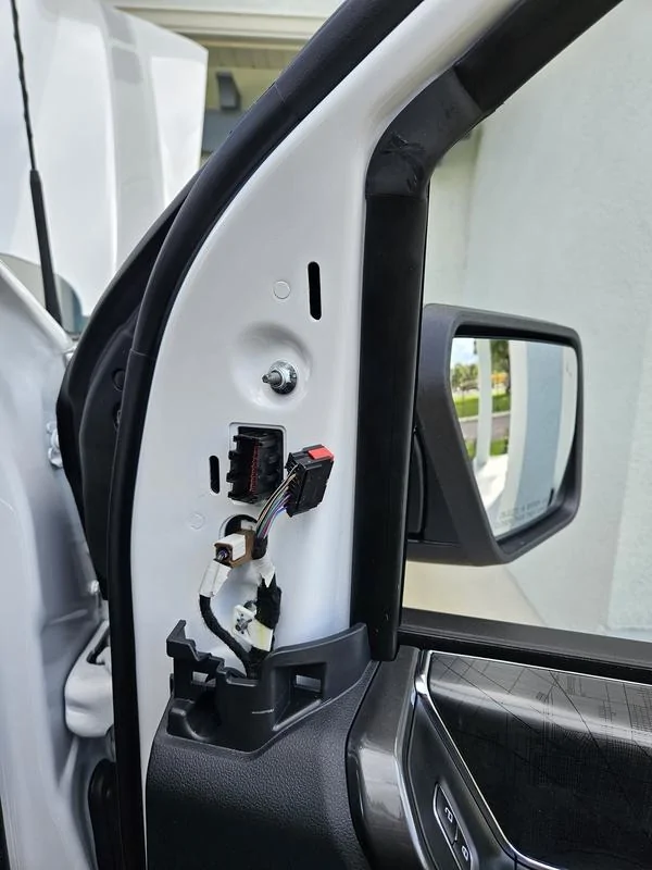

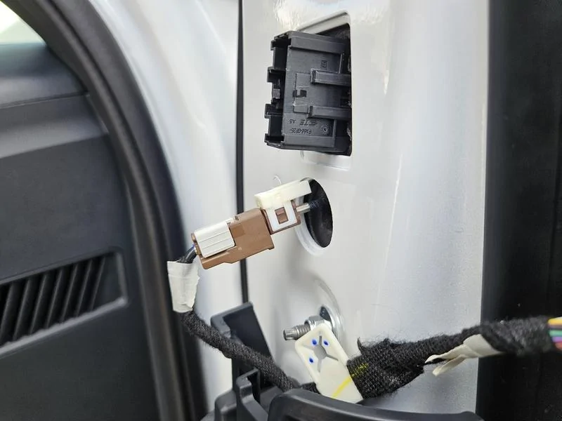

I upgraded mine, which were manual fold/manual telescoping only. There's 2 plugs to remove.
Ford F-150 Tow mirrors plug and play without telescope? 20230928_162317
Ford F-150 Tow mirrors plug and play without telescope? 20230928_162327
The black plug on top has a tab you push down to pull it out. I recommend not trying to use any kind of tool for this, as the tab breaks easily.

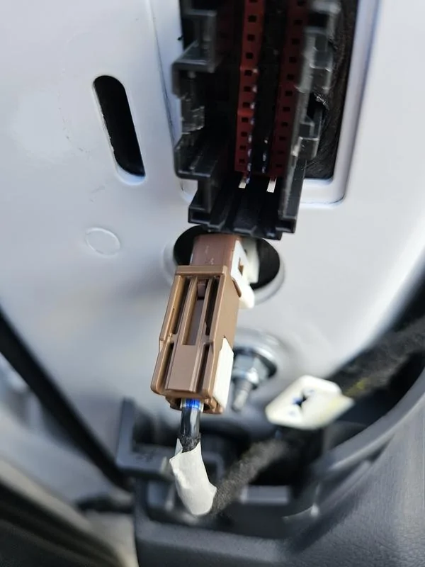

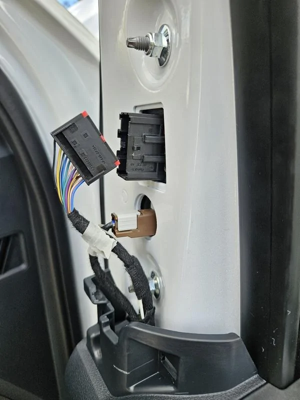

To remove the brown and white plug (which I believe is for the camera), ignore the white plastic pieces. Instead, flip it upside down and push the narrow tab inside the outer plastic rails.
