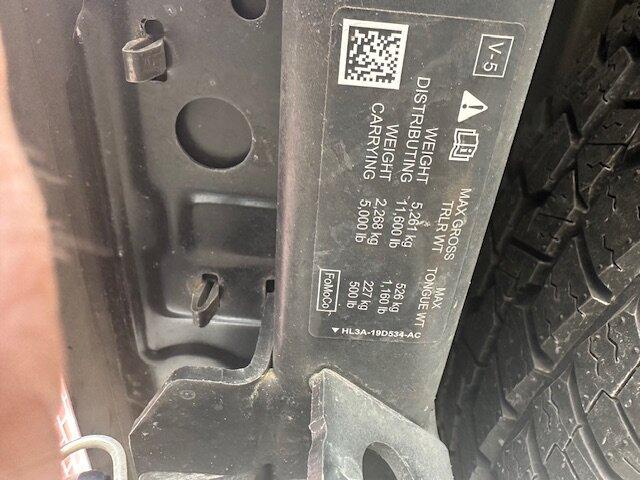

Curious, what's the sticker rating for your receiver (the sticker on the receiver itself) which should never be confused or construed as your truck's rated towing capacity?
Ford F-150 Tow hitch upgrade RECEIVER STICKER

Based on that pic, your receiver can handle all that your truck is rated to tow (and all that's prudent to tow), IMO.
Use a WDH (Weight Distributing Hitch) as appropriate.
Refer to the attached 2021 document to see the trailer limits for your truck as equipped (tip: use pdf search term "hybrid", and don't fail to read the footnotes).
Do not exceed the total payload number on the yellow sticker in your driver's door frame (weight of all occupants, cargo, aftermarket add-ons, and actual trailer tongue weight).
