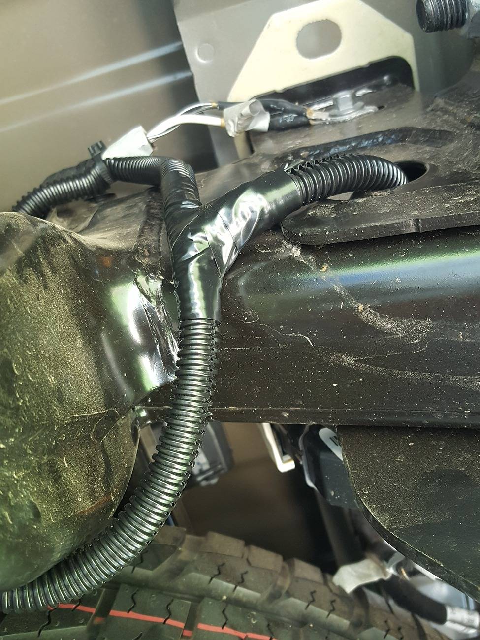

Is there a way to make adding a topper for the 3rd brake light plug and play? Anyone have part numbers for connectors?
Wire is under hood near air box filter thing .
It's buried in a wire harness
If you have a pb. Tye circuit has to be enabled in forscan
Also the wire only works. No matter if a pb or non pb. If key is ON
It does not work as the brakel8ghts do if truck is off
You will need to run a protected wire to rear of truck and up to toppers brake light wire
I ran mine through the frame
Similar to how I ran wire to aux rear lights

Finally getting around to this with the weather improving and found the wire. It looks to be very small gauge. What is the black end on it? Is it just protecting it from grounding out or is it something else I've never seen? And is it necessary or a good idea to add an inline fuse? I need to buy some wire and figure out how much I should buy for the whole run length and some type of conduit to put it through if anyone has a recommendation.

Finished this project up yesterday. I purchased 25 ft of wire loom and high temp GXL matching gray wire with the orange stripe. I used over 23 ft of it more than I expected so sure glad I bought enough. I discovered the black rubber end on the provided brake wire under the hood is probably just to protect the wire from grounding out. I didn't have to remove the air box to get to it but was able to feel it under the drivers mount and pull it out. I used marine grade butt connector to splice in the wire and a marine grade ring connector to ground the negative wire at the end of the frame. That factory wire is something like 22 or 24 gauge. Yikes! Zip ties and tesa tape where needed and routed it through the hole in the bed forward of the drivers tail lamp. Finished it up with a Deutsch connector at the end to mate up to the one I added to the topper. Non powerboost here but still requires truck on for 3rd brake light to work. Thanks again guys!

After a ton of internet probing, I learned about the CHMSL wire that powerboatr provided a picture of. So, at SmartCap's request (and on their dime) I took my truck to the Ford dealer and said please connect my topper's 3rd brake light. The funny thing is that the dealer said "we've never heard of that" and that Ford's technical materials "don't mention that" either. As an alternative, the dealer wanted over $1,000 to establish a connection through my interior and the headliner to connect to the truck's third brake light. Seemed excessive and SmartCap wouldn't approve the expense anyway. I don't blame them.
So I went back home, researched a tad bit more, and did it myself. Couldn't have been simpler in the end. I used the shielded wiring that SmartCap provided. I have a bedrug and pulled the carpet back a bit at the rear tailgate / bedrail to expose an existing hole that drops down inside the rear fender (i.e., I did not go through the taillight housing). As soon as I could, I started fishing the wire through the frame rail until I got to the engine compartment and then up from there.
I grounded in the engine bay and connected to that thin CHMSL wire. Brake light on the topper works!
