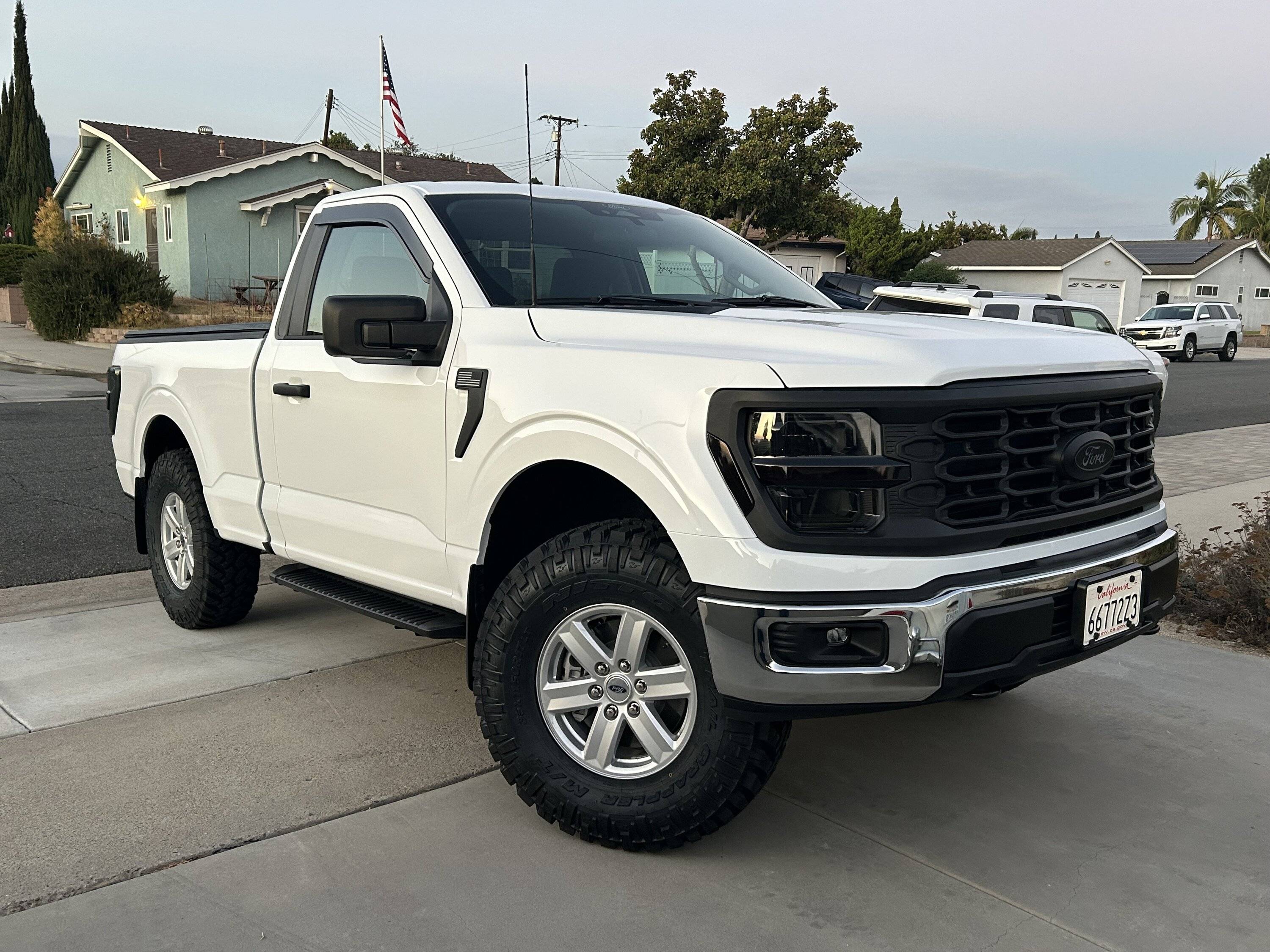

These monsters (35x11.50) weigh 98.6 pounds.
Just a data point for the collective.

It lookes stuffed. You need a lift.
2” coil lift in front and rear blocks removed. No rubbing. I’m very happy with the stance. Any higher and I’d either have CV wear or need to cut frame brackets and that’s a hard no for me.
