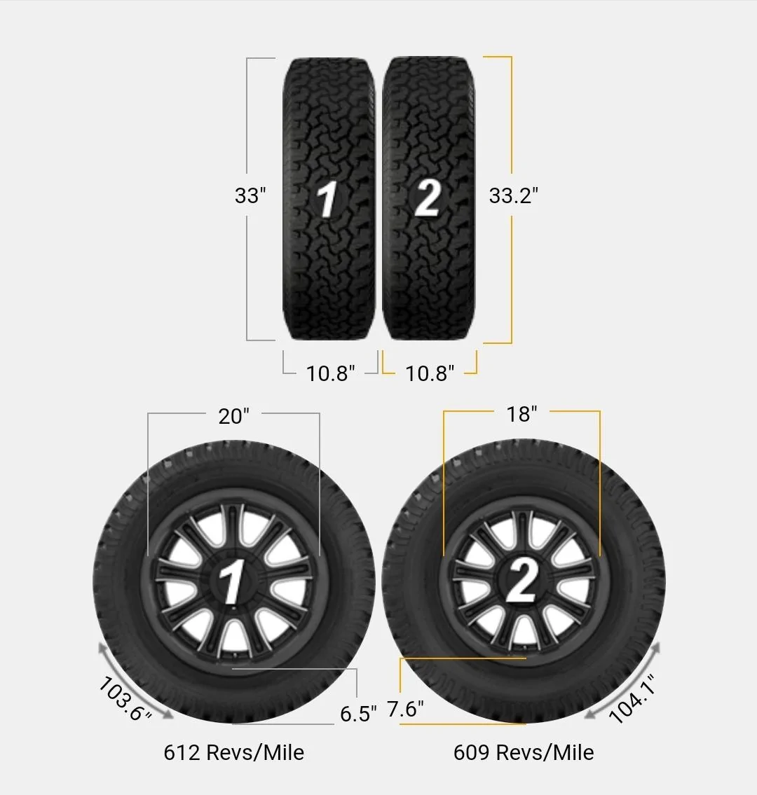

I have a 2022 F150 Xlt Powerboost with 275/60 R20 stock tires and I am looking at purchasing winter tires and rims. Can I run a winter tire that is a 275/70 R18 on the truck safely Instead of the 20” tires?

Based on the calculator, it looks like the 18” tire is about .2” bigger. I think you’d be perfectly fine running that size without worrying about speedo changes, it’ll be a trivial difference in speed

You will not have any problems with the 18s. They'll only be 0.2" taller.
Ford F-150 Tire Size Question Screenshot_20221125-193748_Chrom
