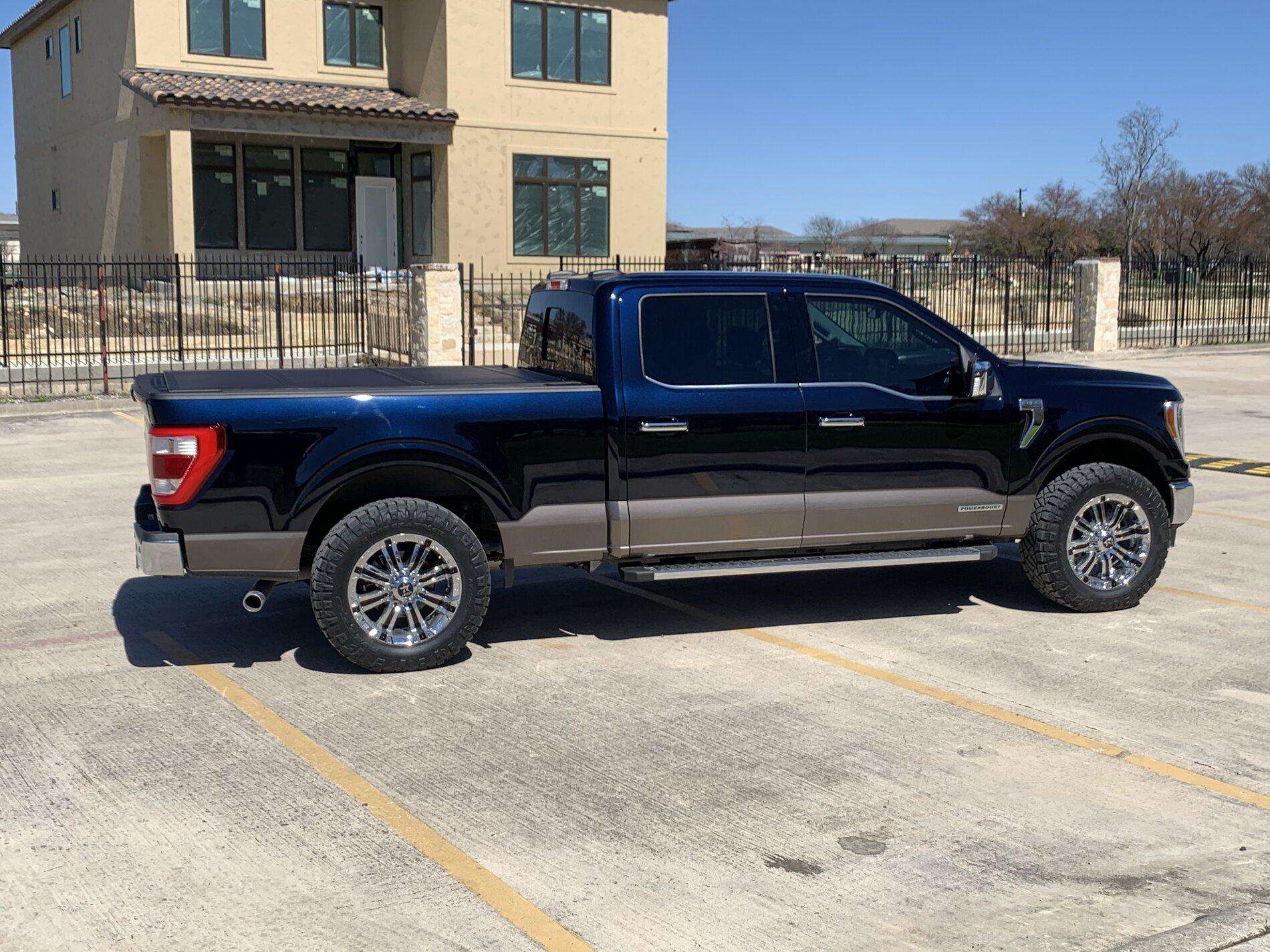

Would like to know as well. Plan on same setup with +20 offset
Kurtis
Feb 22, 2021
30
Arkansas
21 F-150 Platinum
Looks awesome! Thanks for sharing. So even at full lock you don’t rub the UCA going forward or in reverse?
Sorry for the delayed response. Correct, no rubbing at full lock on UCA's or plastic going forward or in reverse.

Thanks for the responses...and photos. My 2021 Platty is coming in a few weeks from now. I am also going with a 2" level and 285/65-20's (possibly Nitto Terra Grappler). Should look very similar...which is completely awesome!!!
Why did you go with the Ridge Grappler over Terra Grappler? How tall is your truck now? Now that I know there will be no rub, I need to be certain it fits in the garage. Thanks in advance!

Had Terras on my Tahoe a few years ago and Trails on my last truck. I liked that the Ridges were a nice in between of the two from a tread perspective but still have an aggressive look. No complaints on the Terra but the Trails were pretty loud and terrible in wet conditions. Haven't had the Ridges long enough to give a review in wet conditions but they are much quieter than the Trails and I have been very happy with them so far. Truck is now at 76.75 inches tall, and from my garage floor to the lip of my garage door is 79.5 inches so it fits fine but not a lot to room to spare.

Does your measure include the 'shark fins'? Ford claims the truck is 77.2" tall. Add a 2" level (which it is debated if that actually adds 2" at the roof with as much rake as they have) and then another .835" for the tire height increase. I was expecting to be right at 80" with the 'sharks'. I have 82-3/4" clearance on the door, so I don't see any issues.

I am at 78 inches off of the fins. I agree with what you said above, with the angle of the original rake, the level just doesn't raise the back of the cab much. I can confirm that the lip of my garage door is at 79.5 inches from the floor which is easier to measure accurately than roof of truck so you are in good shape. Based on your intended use of the truck, I would say Terras are the better option. I put my truck through a decent amount of off road use on steep river valley accesses when towing rafts or my river boat so decided on the Ridge.
