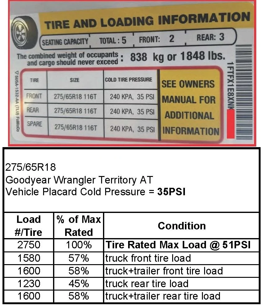

Not the same tire but perhaps the analysis is of interest ....
Ford F-150 Tire pressure for Michelin Agilis while towing? F150 TIRE INFLATION
All the above weights are from CAT Scale, Load #/Tire is axle weight divided by 2. Tire Rated Max load @ 51psi is from the tire sidewall. The trailer is a small 5th-wheel which has a pin weight of ~800# loaded in the bed directly over the rear axle.
Note that when hitched the rear tire load is essentially the same as the front tire load when not hitched and the front is only 20# more than unhitched.
I experimented with increased tire pressures, felt no gain in handling but got a harsher ride; I'm happiest running at the placard recommended 35psi.
Nothing beats actual CAT Scale data, IMO. You might be surprised at how little additional load is imposed on each tire with your rig hitched, especially if you use a WDH.
