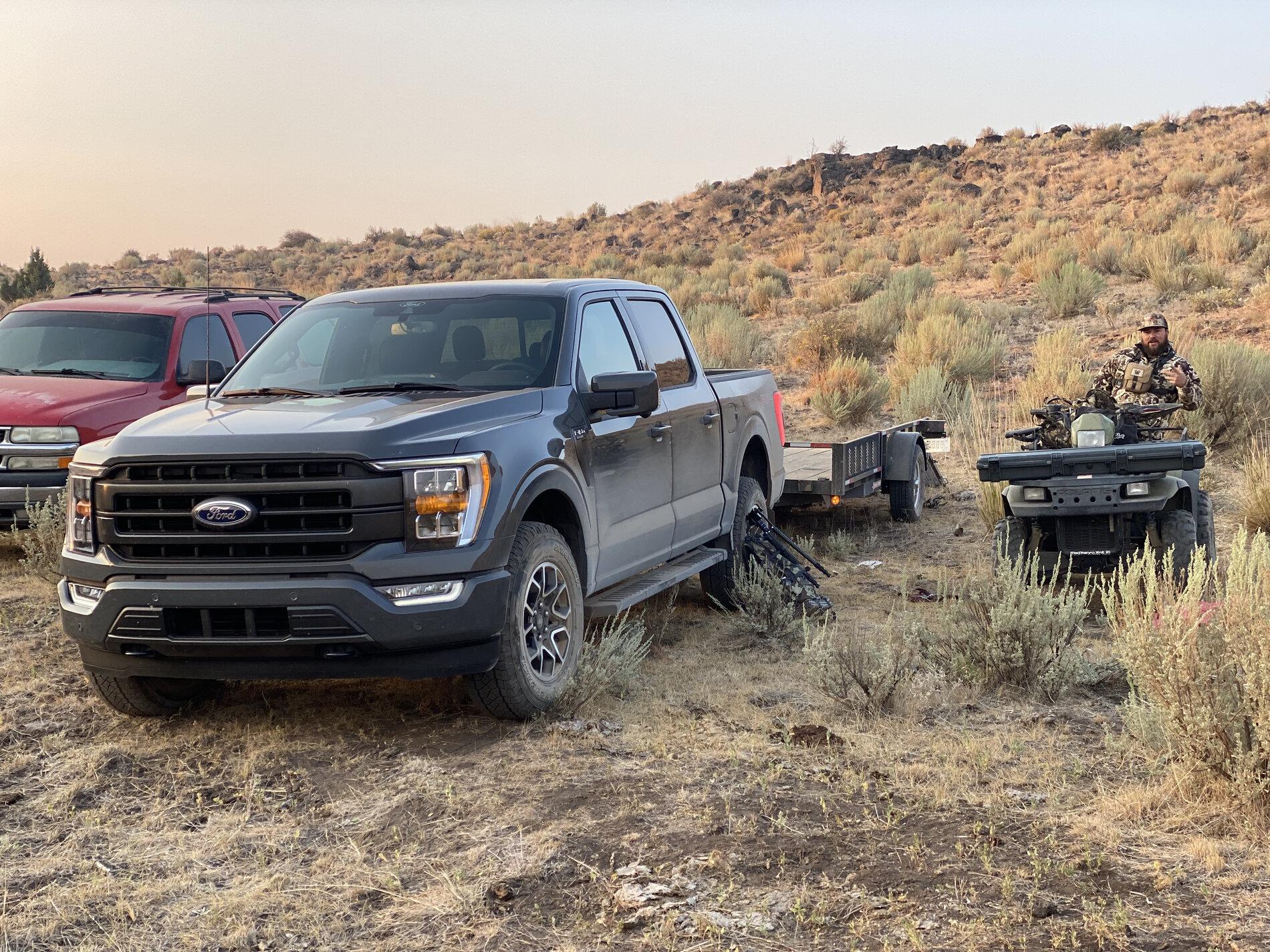

Pics of the truck! (Super happy with it, immediately took it on a antelope hunt, made me realize i need just a bit bigger tire and made me miss my camper shell. So i bit the bullet and put a deposit on a RSI smart cap for when they come out)
Ford F-150 Tire Debate, tall and skinny F162F435-4AC6-49FD-BC76-B1AB1AC2CC8F
Ford F-150 Tire Debate, tall and skinny 26EC7B77-468B-44BC-8D7F-2E6A40A6BBA7
