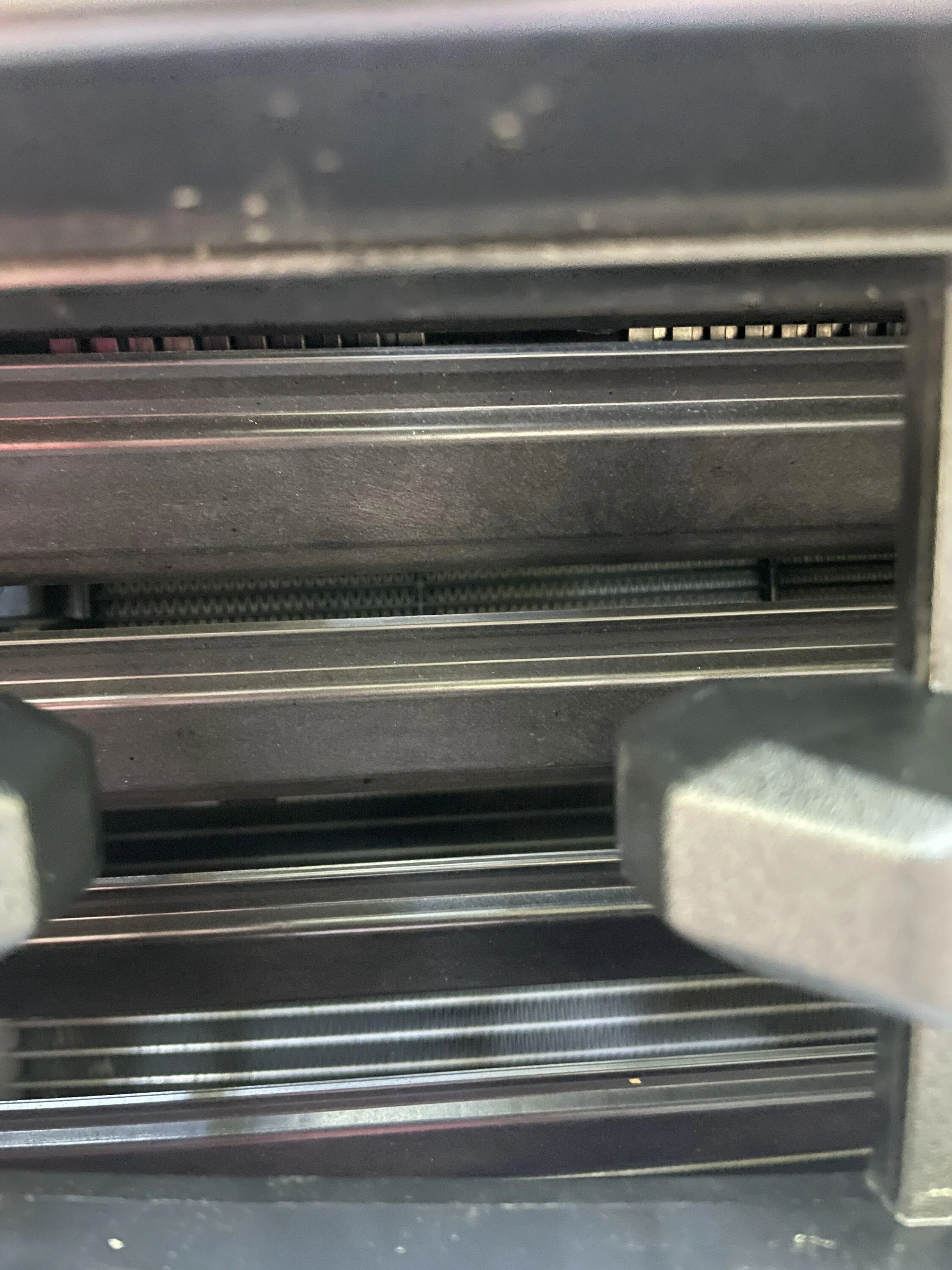

Mine seem to be sitting about halfway open. The truck cycled on for the generator this morning and the ticking was there again. The engine is warm when I took this photo because it was idling for 10 mins or so.
Ford F-150 Ticking (fan hitting cowl?) After Towing IMG_4206
Can you get your ear up close to the grill and the Intercooler and see if the ticking seems to be close to either?
If you ou can get your fingers on one of the louvers, you would likely feeeeel the tick IF it is associated with them.
