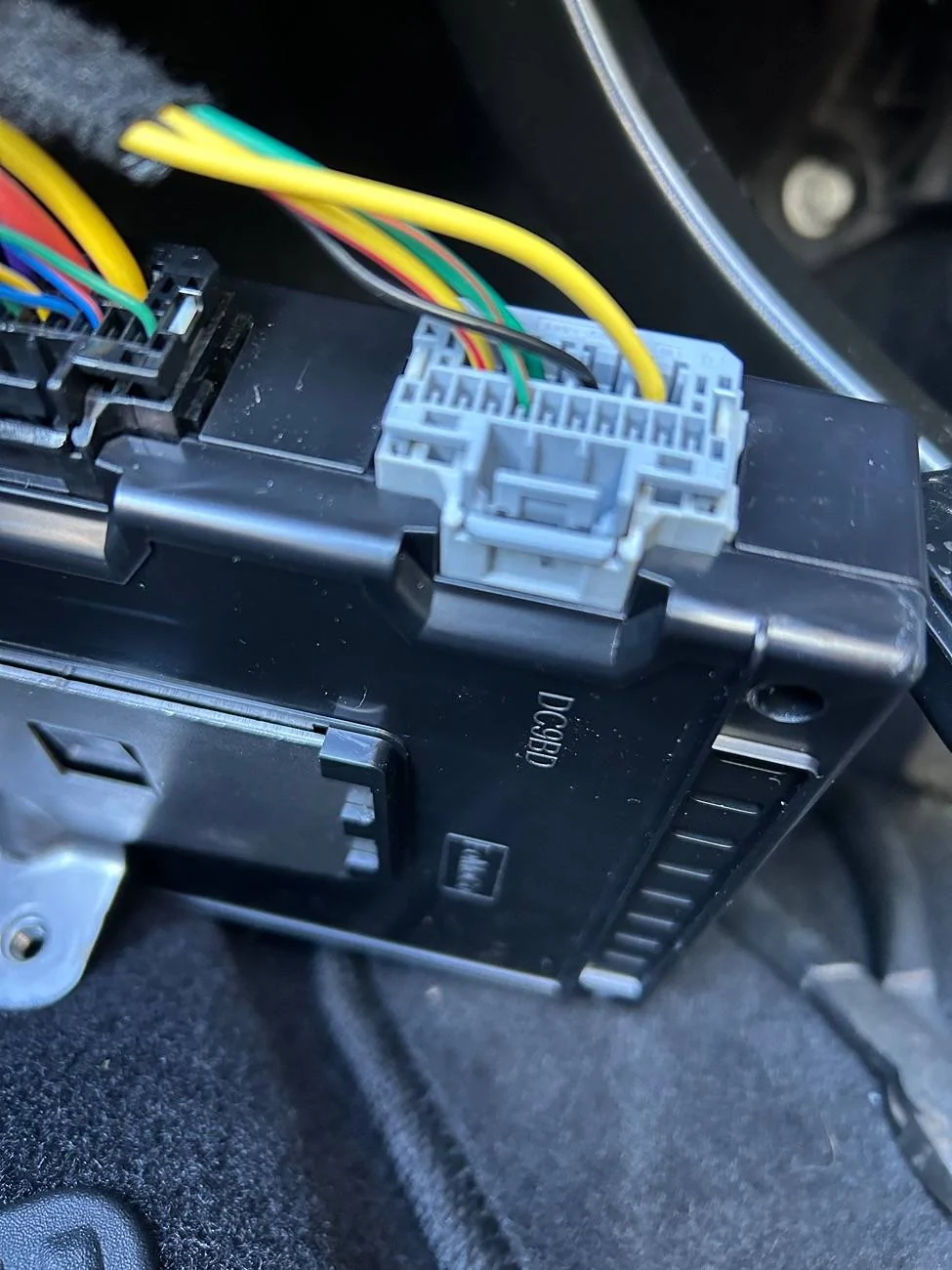

There is a trailer brake controller box ( module) in stalled there. There are two plugs connected to it. I suspect one of them goes up to the dashboard where the coin holder is. Be the coin holder would be a connector for the oem controller.
I need an after market two and connector that would take the place of one of the two connectors.
I’ve reached out to Tekonsha but haven’t received a response

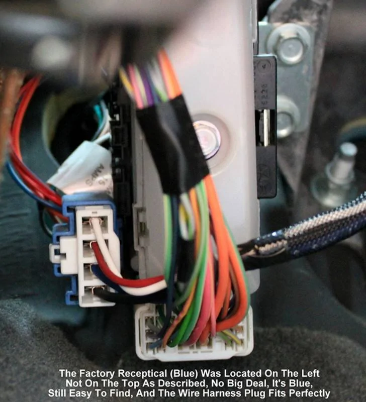

This is not where the connector for the aftermarket controller is located. You don't use any of the OEM controller plugs on the OEM module. The pic will show the correct connector for an aftermarket controller.
Ford F-150 Tekonsha P3 trailer brake controller rid12695_r1_800

GRT. Thank you for the information. I looked very hard in this whole area even using a mirror and flashlight but was unable to find the connector you described. My XLT must have some variation to yours.
I appreciate your help
