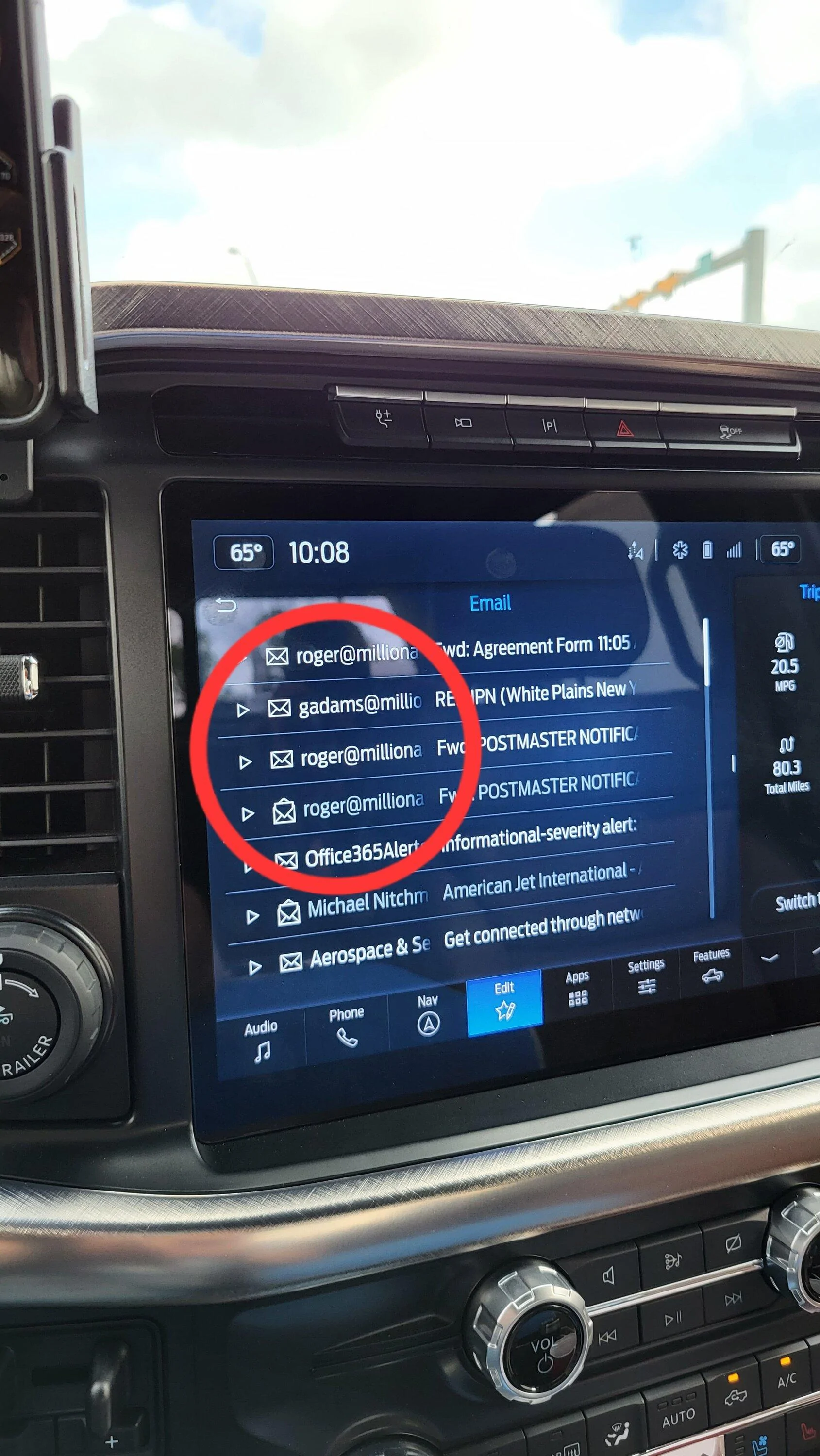

After some discussion and research, I have found two things to be true. 1st, texts and emails are viewable on the sync screen under certain circumstances and 2nd, sync tech doesn't know shit about sync 4.
I'll explain. The issue is Android Auto. When your phone's connected with a cable or via Bluetooth, both email and messages are viewable on your screen just like in the videos in the above posts. If you are connected via Android auto, emails and messages are NOT visible.
If you go to the phone list screen...
Ford F-150 Sync 4 won't notify about new texts 20230402_123154
You will see your phone and 3 icons.. They control how's your phone is connected to sync. If you touch the phone icon, you are just on Bluetooth and the email and messages can be accessed and viewed. If you tap the Android auto icon, no email or messages. They can be toggled back and forth, but you have to choose phone if you want to see your messages list.
