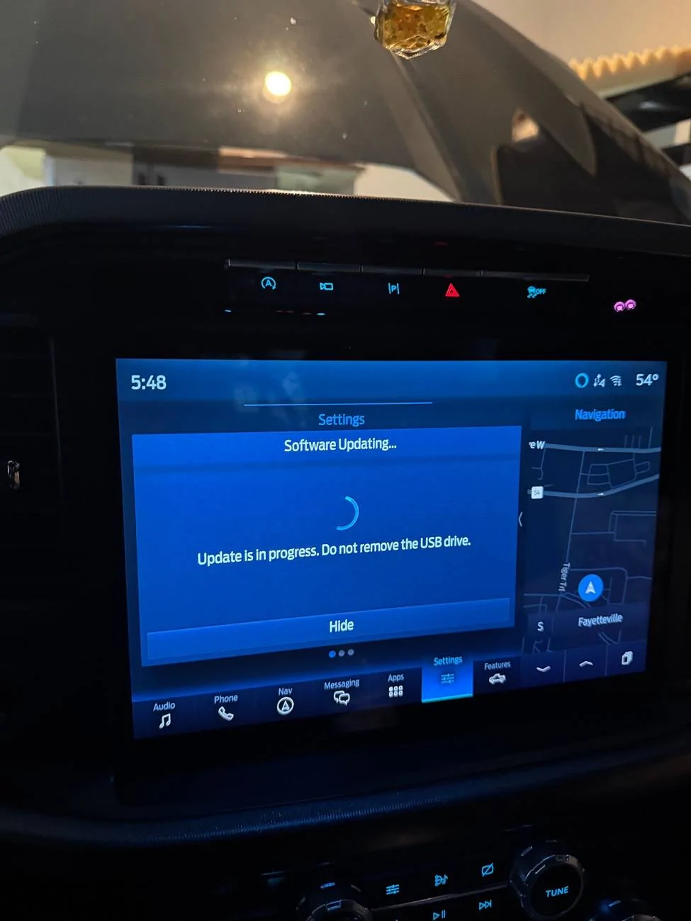

Hello,
I had a ton of updates that I performed on FDRS. I'm currently doing last update APIM for sync 24127 before making changes in FORScan for BC 1.4. It's been updating on the screen for almost 2 hours. Just making sure this is normal....
Ford F-150 Sync 24127 - FDRS IMG_8160

No. If you havent gotten the restart required.. Press hide and then try to do the 10 min restart.

Thanks, should I take usb out or keep when I restart?

Yes..
Upon restart go and check your version. See if its at the new one or not.. If not then try the update again.

SHould only take 10 min or so
Still doing the same thing and it's been 20 minutes or so.
Is it ok if I just do my FORScan changes for BC 1.4 and not worry about the sync update?
What could cause the sync update to not progress?

The PSCM isnt a issue.. DTCs arent abnormal. Dont worry about the ACM
Not sure why youre having issues with the APIM update.. may need to remake it.

Were you able to get it to go through?

Nope trying a new jump drive now...same thing
That is definitely a weird one. I used a ssd external drive when I did mine, took forever to pickup that the drive had an update, but it went through in less than 20 minutes if I remember correctly. The ipma update is what gave me a fit.

I typed too soon it's going through now I believe. It asked me to restart and wait 10 minutes. This is a first and the screen did something different. I'll keep you posted. I went to staples and purchased a 3.2 usb drive.

If it told you to wait 10 minutes you are good!
