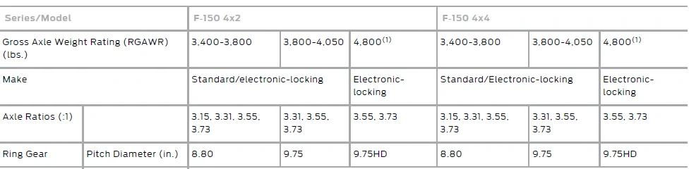

My truck stock runs a 3.31 gear and 32" tires. I installed 34" tires and did the conversion to get my truck back to stock gearing so there's no extra stress I need to go to a 3.55, I'm thinking if I'm gonna make the jump I may as well go to a 3.73, question is does the dealer then reprogram to accommodate going to a 3.73 since my new stock setup technically should be a 3.55 without any reprogramming.

3.31 to 3.55 is a 7.2% increase in ratio. Hardly seems worth the expense unless you feel like the trucks performance has suffered too much. I would think with the 10 speed, it handles the larger tire fine. Going to 3.73 is a 12.6% increase. If set on making the change, I probably would go to 3.73 and have the dealer make the adjustment (call to confirm they can make the change).

Will have to go aftermarket for 3.73's.
The 3.31 and 3.55 is the 8.8 rear end. The 3.73 is the 9.75 rear end.
Thought I read the 9.75 is the 12 bolt pattern which mine is 12 bolt but a stock 3.31

I'm running 295/65-20 (35.1 tall) on my factory 20" wheels with 3.55s with the 3.5 EB and it turns them pretty well. I wanted 3.73s when I ordered the truck but wasn't available with my options.
All 3.31 are 8.8 rear end. All 3.73 are 9.75 rear end.
If you are 3:31 stock, you will need aftermarket gear set for the 8.8.
A note: The “super 8.8” (available in -both- IRS and solid axle) was introduced in 2015 for Mustangs and F-150s and includes larger bearings, a longer pinion with larger nut, 34 spline axles or half shafts, and most importantly for our discussion, a 12 bolt pattern. So you can’t tell them apart solely by the number of bolts anymore.
You can tell them apart by cover shape, however, as the original 8.8 had a rounded square shape and the 9.75 has sort of a tapered reverse D shape, and the super 8.8 has sort of the same rounded square shape of the original 8.8, just with a *slight* taper to the top, but keeping the flat bottom of the 8.8 that’s very unlike the 9.75.
Picture of old 8.8 cover https://www.f150hub.com/drivetrain/ford-8.8.html
Picture of new super 8.8 cover shape, aftermarket design but the pattern is the same: https://yourcovers.com/pml-ford-88-super-12-bolt-differential-cover.html
Picture of 9.75 https://www.f150hub.com/drivetrain/ford-9.75.html
So to tell them apart easily, one really just needs to check if the bottom of the cover is flat or not. If the bottom is tapered, you’ve got a 9.75. If it’s flat, it’s not a 9.75.

Since your truck is a 4x4 I'd budget at least $2k to have the front diff regeared too - rear is fairly easy, front is a specialty service I've been told
