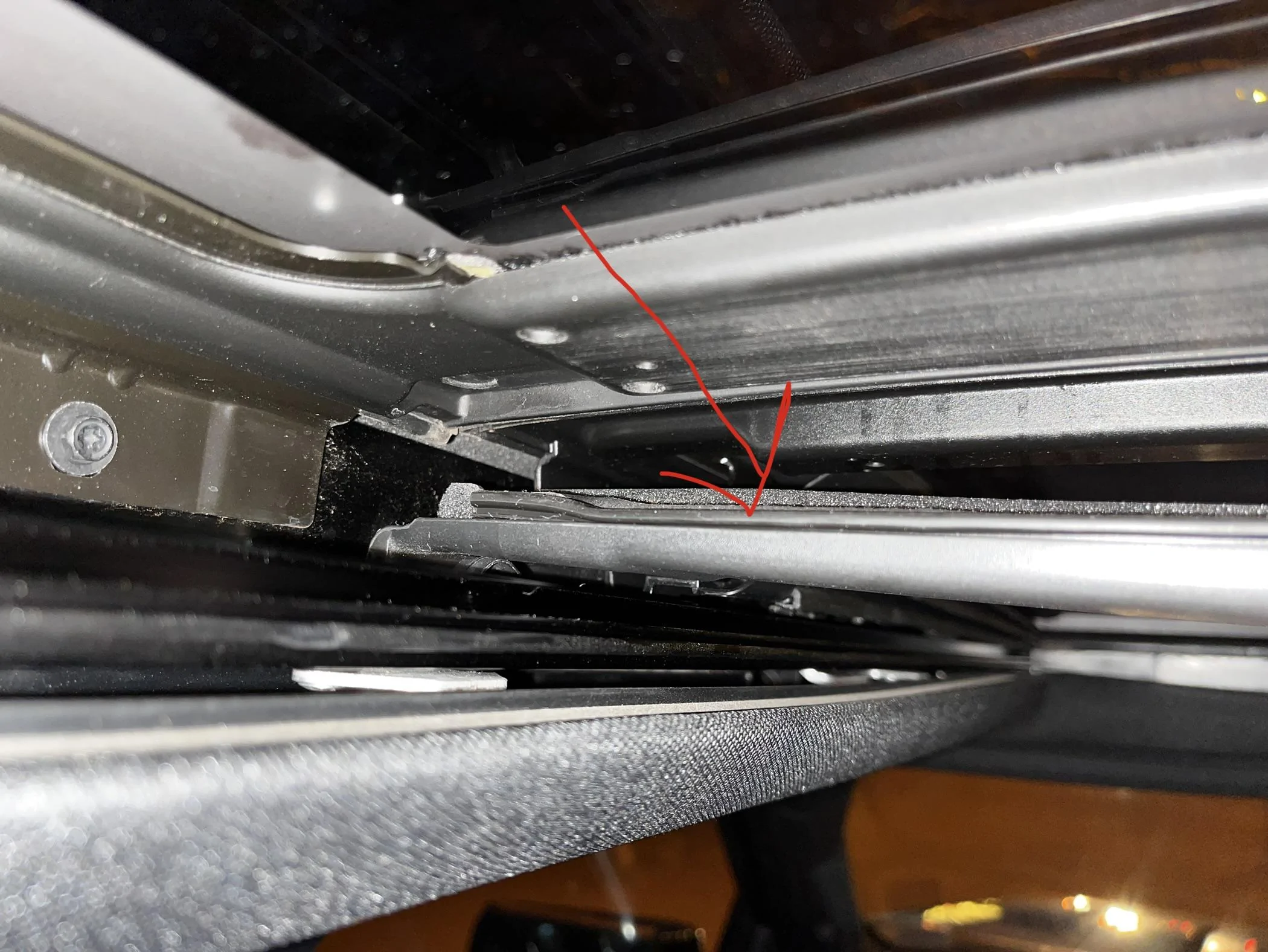

Think you can post few pics on the locations where you put the weatherstripping?
Roxerroneous
Dec 20, 2022
New Jersey
2021 Lariat Powerboost
Ford F-150 Sunroof Issues? B66E5B81-B1F1-4AEF-8CDE-C8EF340A3587
The arrow is pointing to the piece right above the spring clip.
Ford F-150 Sunroof Issues? 7658A5F2-06AD-4EAB-A3EF-BAC3D48AE675
I just pulled it down and put some weather stripping along the entire length on the rear side (as that was the part making contact above)
