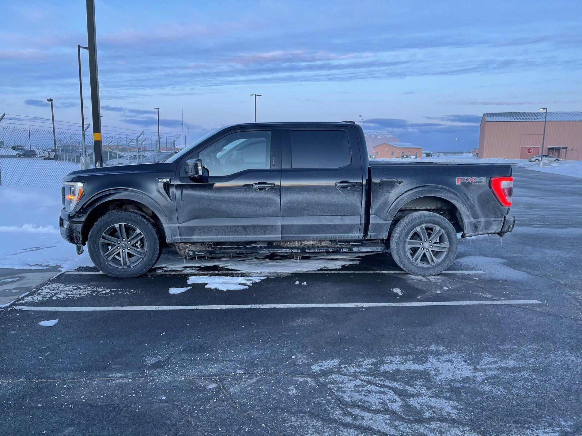

I’ve filed a buy back with Ford. My dealership and I are puzzled at all the small but consistent electrical/mechanical issues my truck has had. I’m really hoping Ford does the right thing and allows me to trade in (at no cost to me) my F-150 for another truck. I was torn between a 2021 F-250 Tremor and my lariat, now that I’m having issues I’ve decided I’m done with my truck and hope to be ordering my tremor soon. I’ll keep you all posted.
