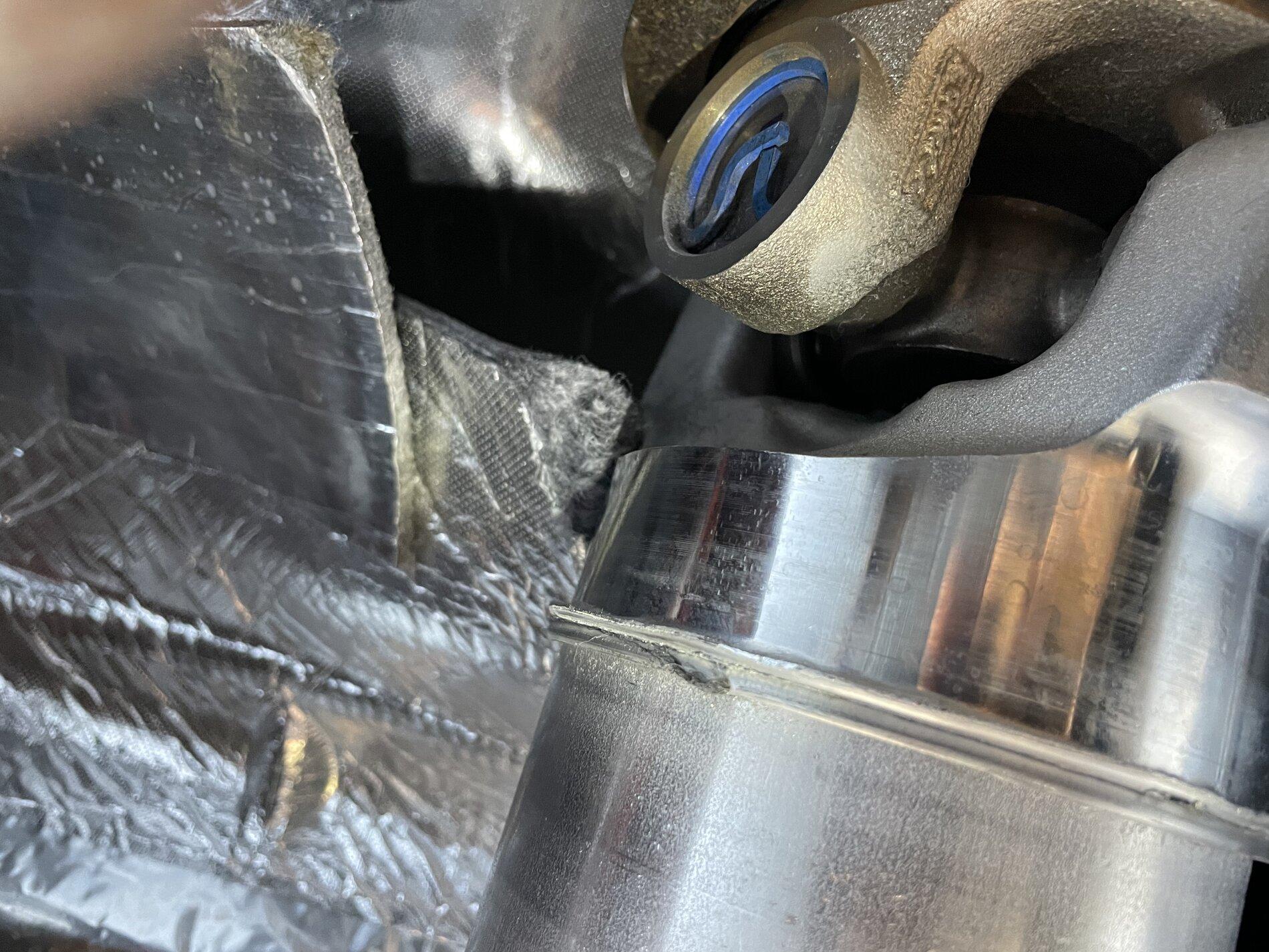

On my way to the lake, I heard a loud speed related thumping. Think baseball card against a bike wheel spokes but deeper sound.
It would start at 5mph, slightly louder off throttle.
I climbed underneath and found the sound deadening material came loose and contacted the driveshaft.
I was able to push it back up and I’ll have my dealer look at it soon.
Has anyone else experienced this issue?

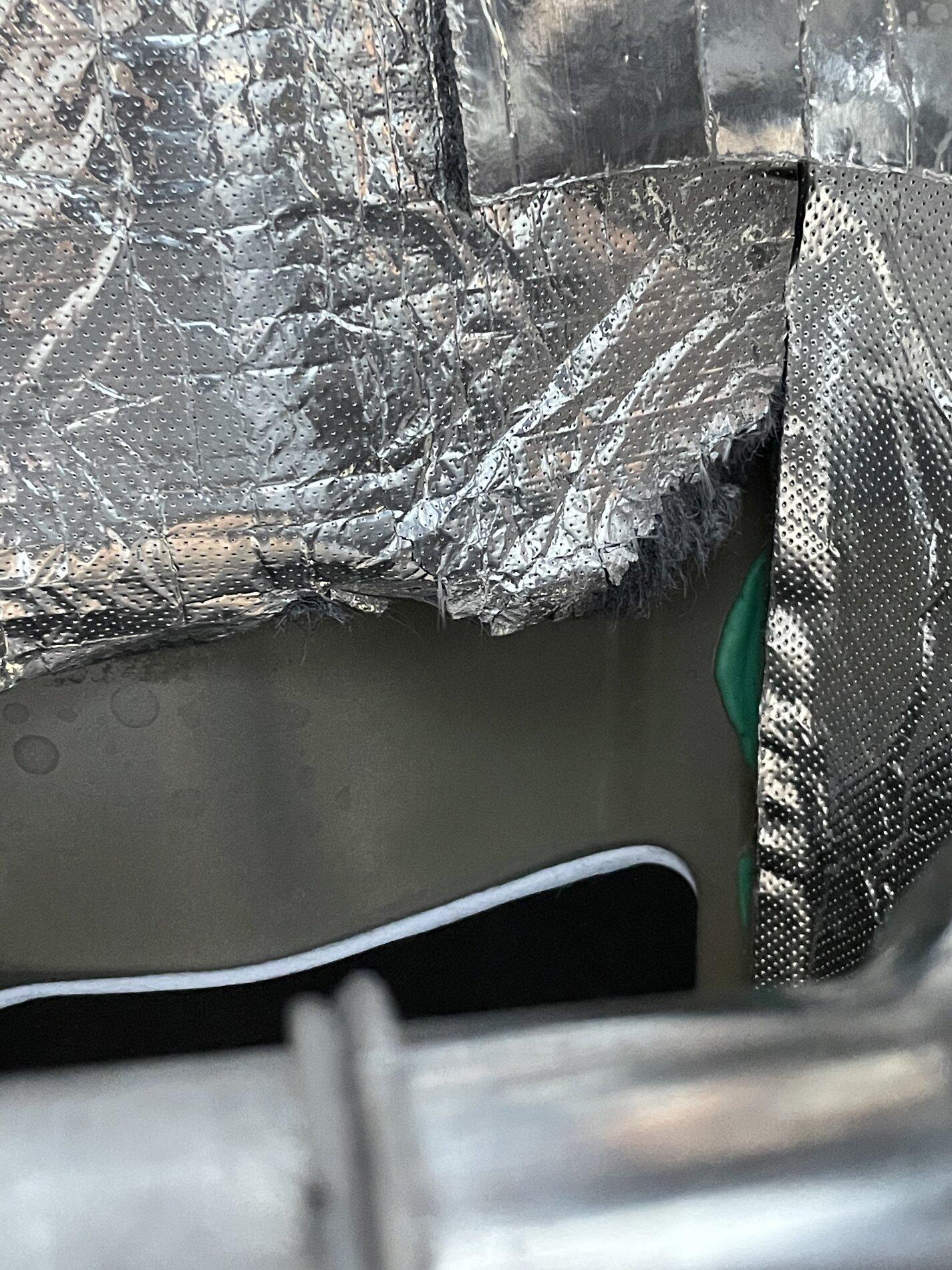

after I pushed it back up.
You can see the corner is rubbed off.

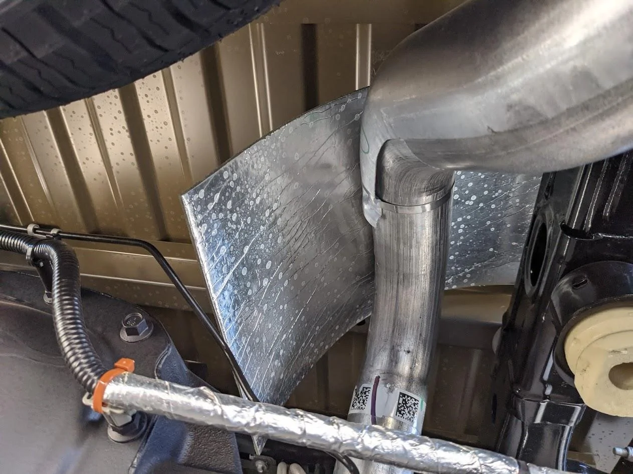

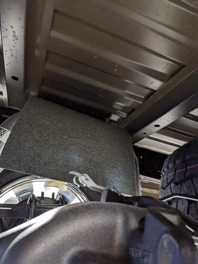

When I picked mine up from the dealer I also had a panel that was not secured, however mine was over the 90 degree bend in the exhaust so it wasn't nearly as dramatic as yours.
Ford F-150 Sound material into driveshaft PXL_20210330_212758072
Ford F-150 Sound material into driveshaft PXL_20210325_205742939
Ford F-150 Sound material into driveshaft PXL_20210330_212811490
Dealer just stuck it back up and it's been secure ever since. Every once in a while when I'm down looking to see how my crop of rust is doing I'll check to make sure it's still there and hasn't caught on fire yet.
