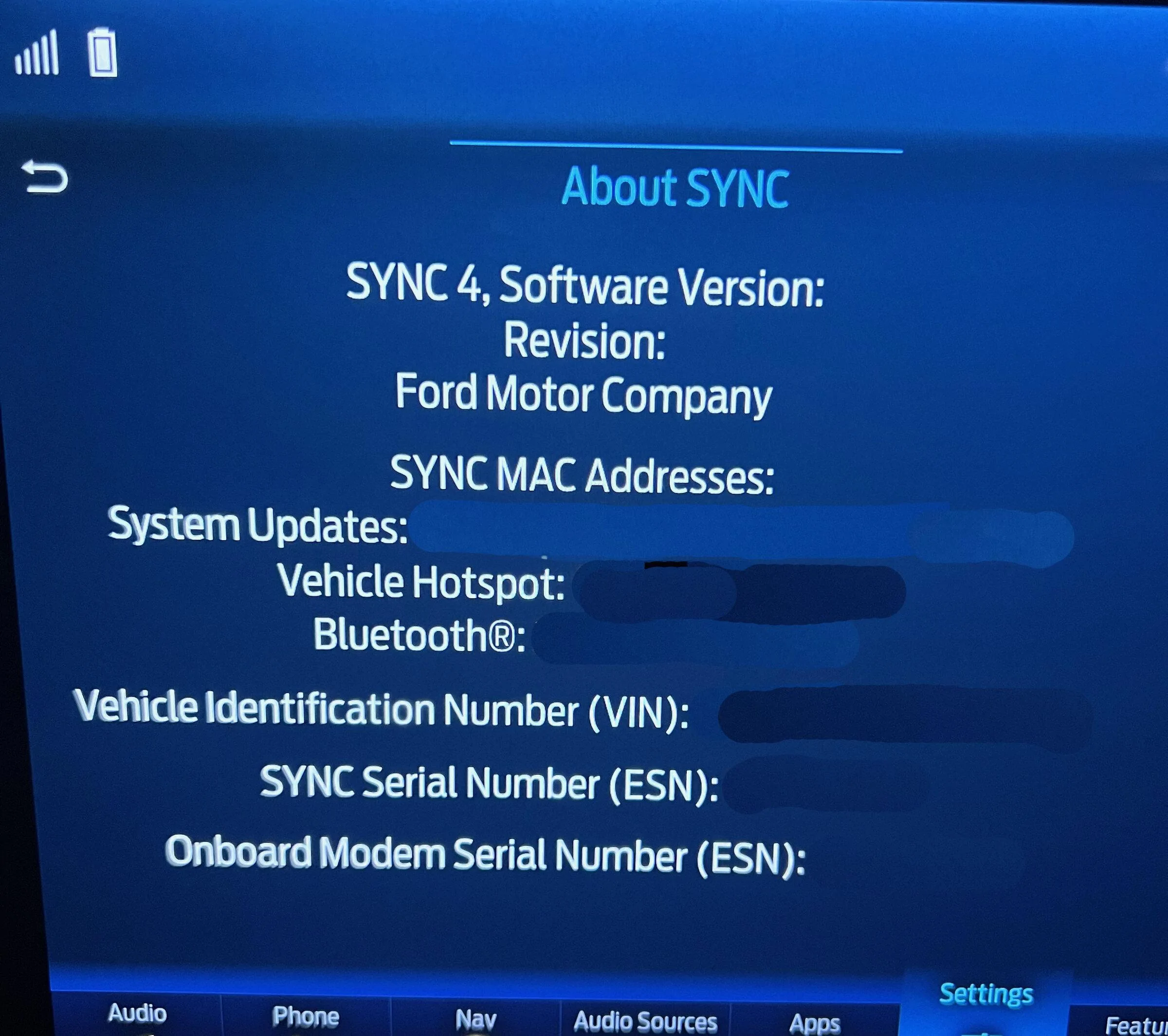

For a brief few shining minutes last night, my update preferences were set (automatic) and I could see the version of the firmware I was on. Then a few hours later, it disappeared, like a creaking old ship into an impenetrable fog bank.
Ford F-150 Software Update Preferences not working? MirabileDictu
Ford F-150 Software Update Preferences not working? After
