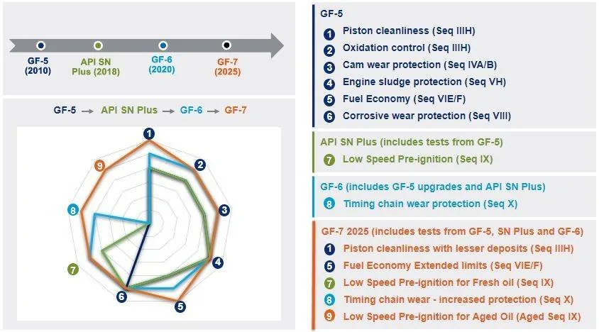

On this Ford Page for 21 F-150s there is a "GF-6" rating on the oil. Note that references to these GF ratings state that it is not backwards compatible (EG don't use GF-5 or lower even if the viscosity is correct). Bottom line read the label fine print. https://media.ford.com/content/dam/fordmedia/North America/US/product/2021/f150/pdfs/2021-F-150-Technical-Specs.pdf
You might find this interesting since you mentioned GF-6 oils. In practice GF-6 oil only offered added LSPI protection when new. Aged GF-6 oil offered very similar LSPI protection to the GF-5 and API SN Plus oils that GF-6 replaced.
Starting in 2025 we should start seeing new GF-7 oils that offer greatly increased LSPI protection for aged oil. This definitely seems like a worthwhile upgrade given the very long oil change intervals that most manufacturers recommend, especially since LSPI resistance isn't something that most labs test for when you send in a used oil sample.
https://www.oronite.com/products-technology/passengercarmotoroils/ilsac-gf-7-specification.html
As a global leader in passenger car motor oil additives, Chevron Oronite will offer a range of solutions to help its customers prepare for the implementation of the new GF-7 category. One of the most important priorities of the new ILSAC GF-7 category is to help deliver improved fuel economy in addition to tangible benefits for OEMs and consumers, as shown in the chart below.
Estimated ILSAC GF-7 performance relative to GF-6, API SN Plus, and GF-5.
