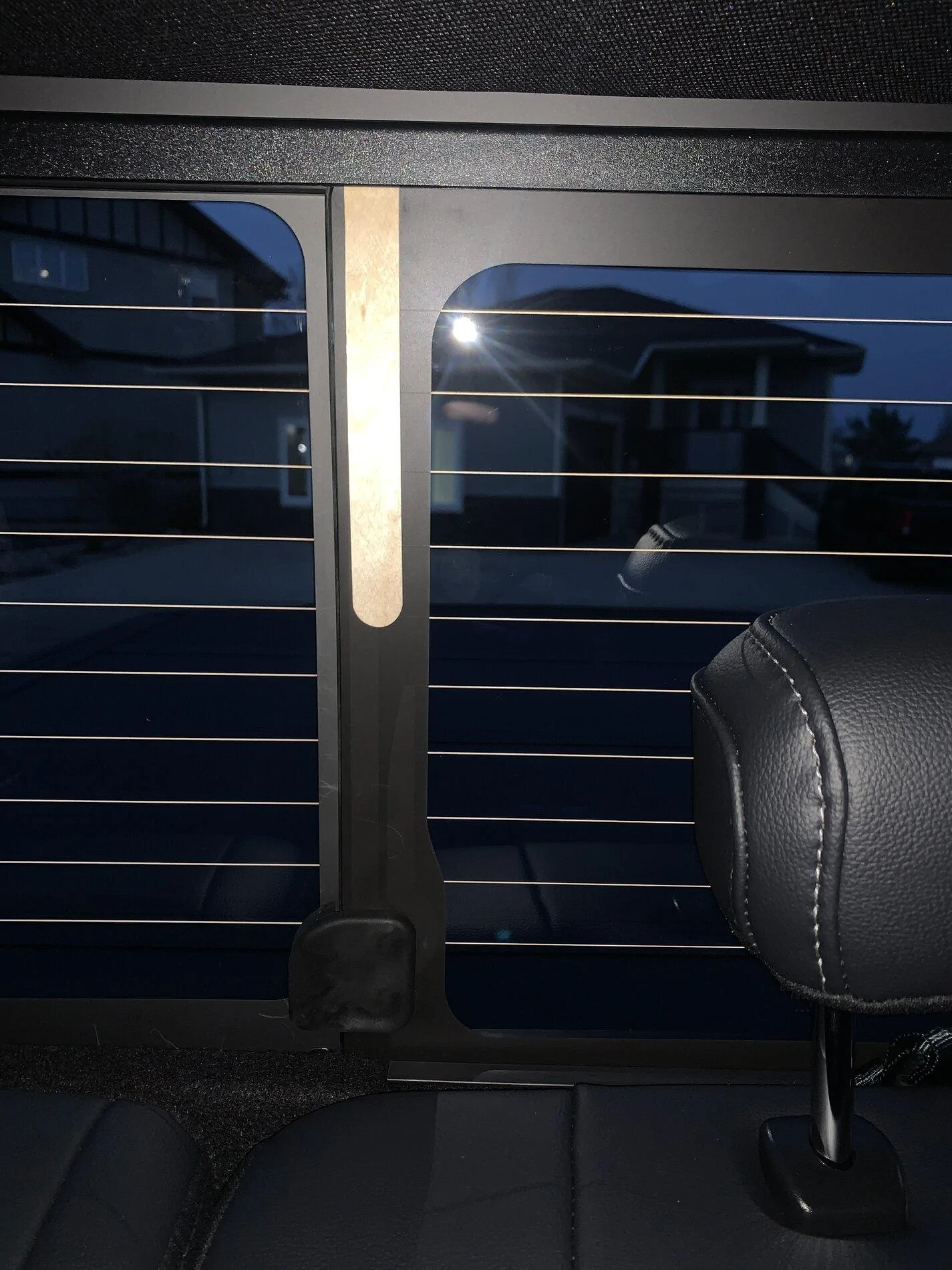

Just took delivery of my truck yesterday with B&O unleashed and the sliding window rattle is driving me crazy.... rattles when closed and a bit less when open but still rattles... if anyone finds a solution please share ... otherwise loving the truck so far

No more rattle.. wedged with a tongue depressor / ice cream stick. Not The perfect fix because it will fall out if I want to open the rear window but it's good for now
