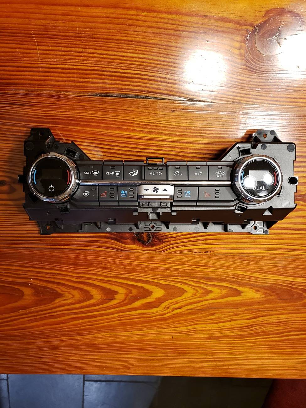

The part number for a 21 Lariat 502a would be ML3Z-19980-K this is w/ digital readout on knobs, w/ heated and cooled seats w/heated steering, w/defrost. And will fit your truck.
BUT,
The problem is in programming it for your truck. It is and isn't plug and play. The HVAC module, which is what this is, is internally hard coded with a software part number and when you attempt to program it with FDRS it will fail to program due to a part number mismatch. FDRS will only program a module that has the correct part number. This can be overcome if you know how to use Forscan (Beta) and would allow you to retrieve your current software and write it to the replacement module, then you would have to also transfer the Asbuilt information from you truck and write it to the replacement as well. Not for amateurs, I wouldn't attempt it myself. This leaves you with a module that can nolonger be updated via OTA or FDRS should new software become available
Option 2
If you buy a used take out it will work as it's been programed, but you will not know the software revision level, and again updating it becomes a problem.
If you go with either of these options, make sure you've first updated you're existing module to the current level. An update for this module was released in FDRS last summer that addresses Evaporator freeze up issues the new software changes Evaporator temp sensor ranges and AC compressor cycle timing, and if you're in a high humidity southern state this can definitely be a problem.

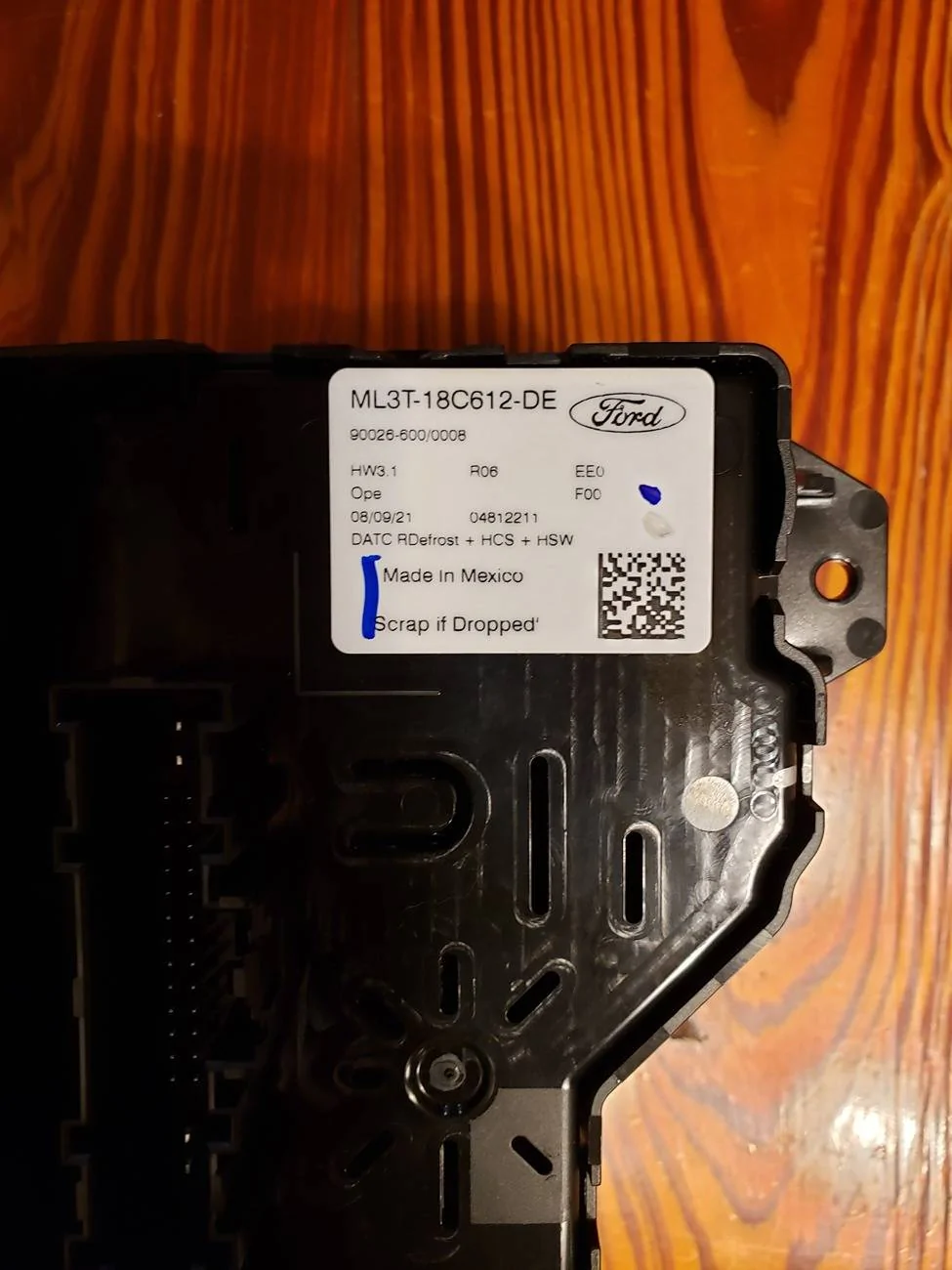

CCM-404 AND ML3Z-19980-C are the same part. Ford uses a few different part numbers to Identify any particular part. The CCM-404 is what we refer to as the "short number" the 19980 is the "long number" also referred to as the service number. Additionally there will be an engineering number that's typically molded or stamped on the part. For example there 5 different engineering numbers for that Control Assy
ML3T 18C612-CB
ML3T 18C612-CC
ML3T 18C612-CD
ML3T 18C612-CE
ML3T 18C612-CF
If you need more help looking anything up let me know. I have been in Ford parts for 15 years at a dealership.
