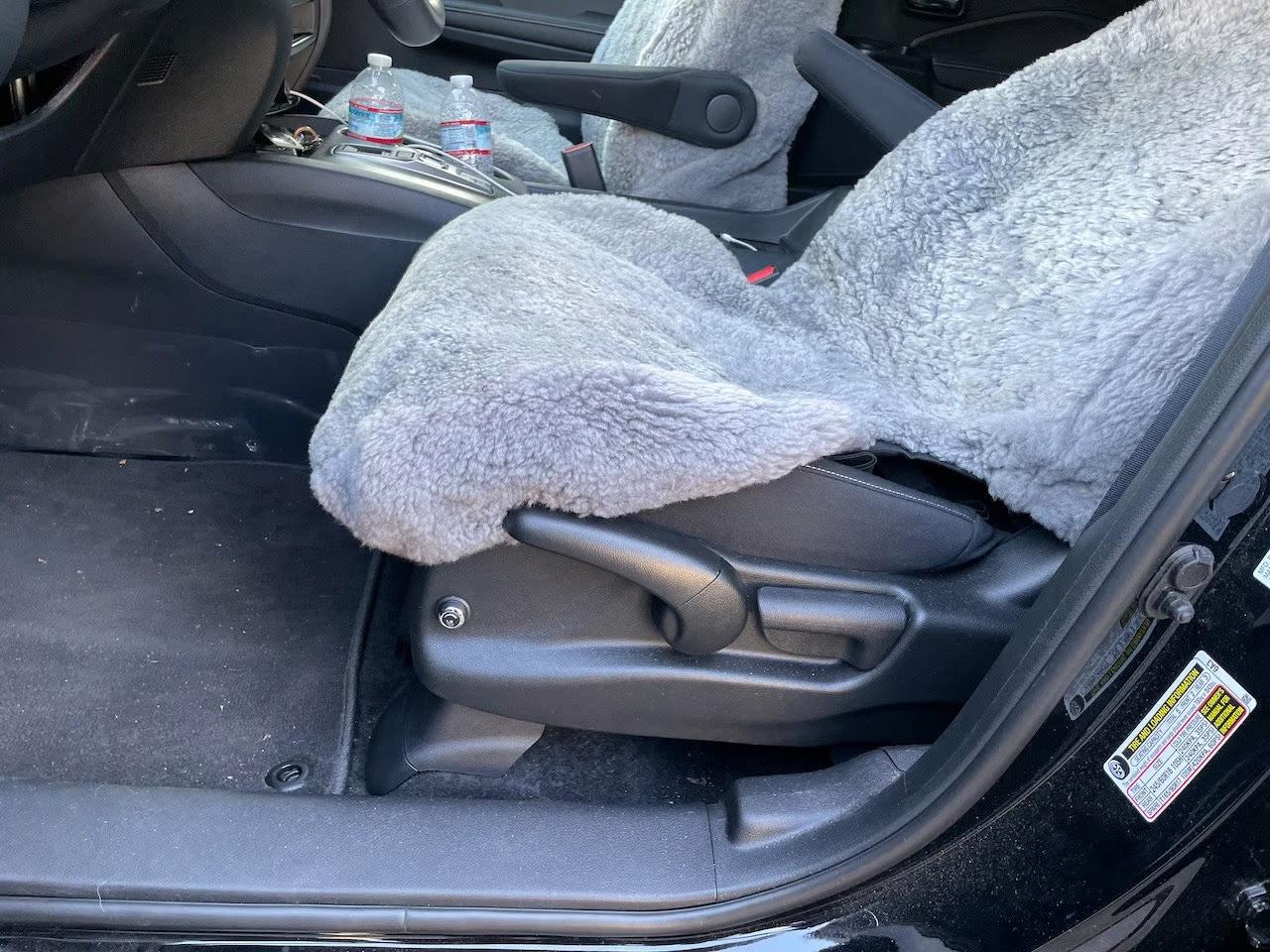

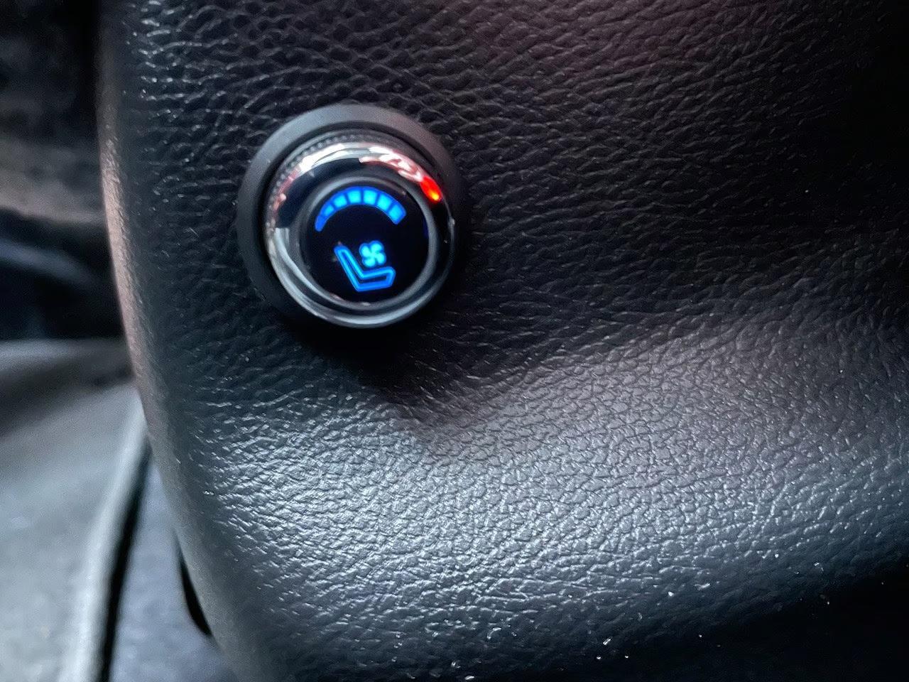

I hav e done cooled seats on my own before in my Honda Ridgeline and will be doing this in my F150 soon enough (I still have all the parts) You can take that approach.
This is the video of the side blow fans I used. Later I actually changed it to direct fan.
Using Aliexpress parts. Was cheap considering
If you are interested I can find the parts list

I understand your approach. Just heads up when I was done with my setup it looked OEM and worked very well. Compared to OEM seats with vents mine would freeze your butt. All for under 80 bucks
here is the product I used
AliExpress Fans
Ford F-150 Seat Upgrade cooling knob 2
Ford F-150 Seat Upgrade cooling knob 3
Ford F-150 Seat Upgrade seatCoolin
