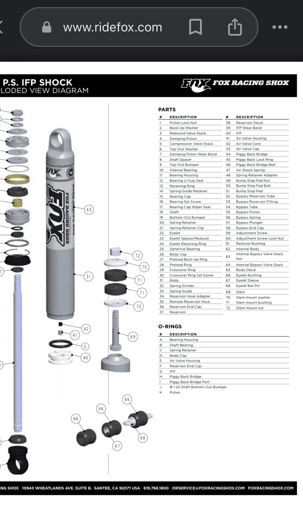

I recently got the Roush 2.0 suspension kit installed on my 2021 F150 XLT v6. The front passenger side had a thumping noise coming from the wheel well while driving so I had it looked it by a local shop. After reviewing it the shop called and said the front coilover is missing a bushing. I picked up the kit from American Trucks and they referred me to Roush for a warranty claim. At the moment I have not heard back from Roush.
Has anyone experienced this issue?
I attached the exploded view below. I think it is the lower #71 that is missing.

There is no bushing on top. Only thing on top is a nut and washer to the to hold the top hat on #6 on pic

Thanks Bob, these are the stock struts. I’m referring to an after market set made by Roush and Fox.
