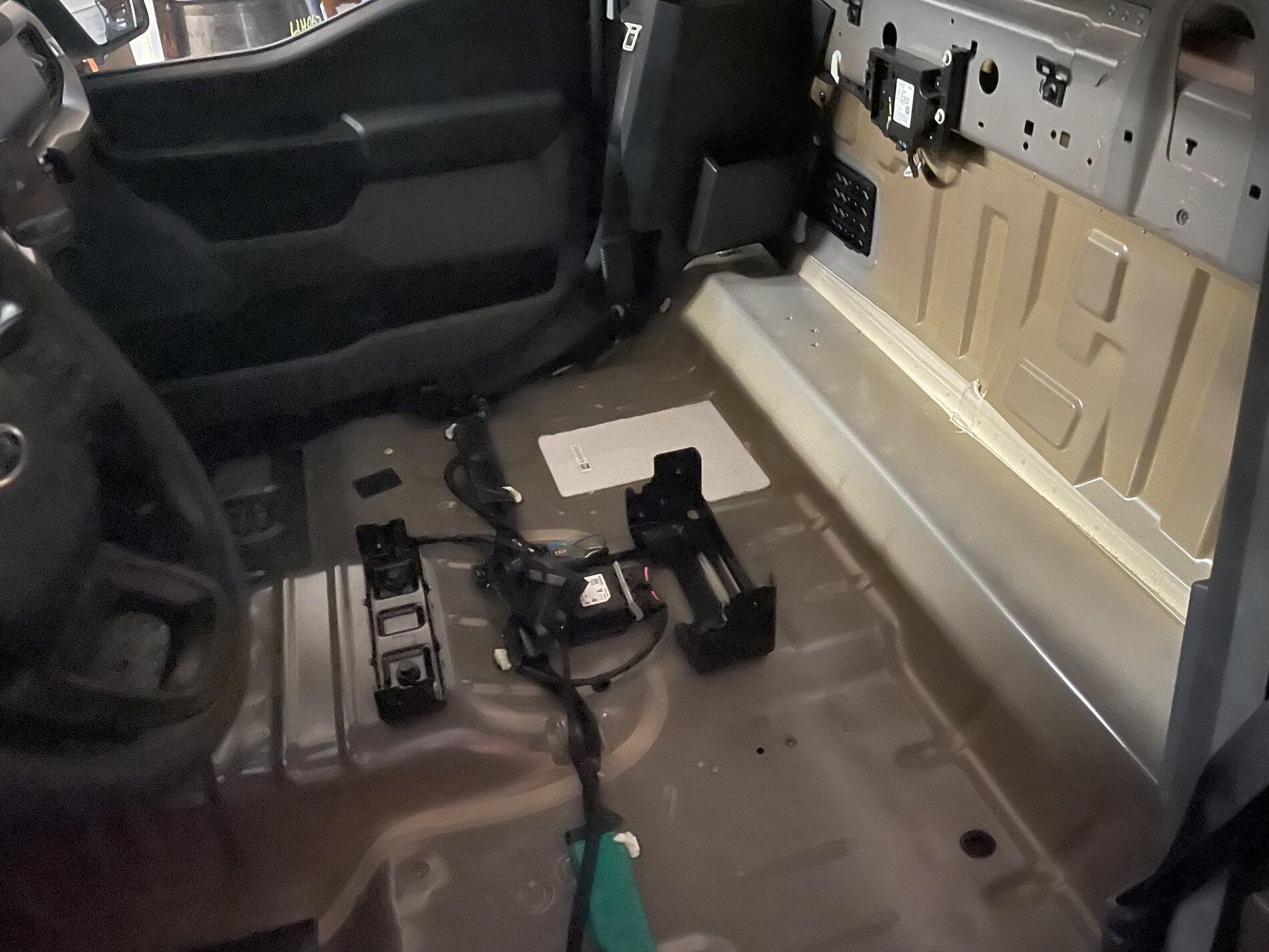

Well that didn't take very long, I'm going to start throwing down some Kilmat 80 and then 4mm closed cell foam over the top. Hopefully that will be enough to please my ears ?
may as well toss in a bass cannon or something fun since you got her naked. :)

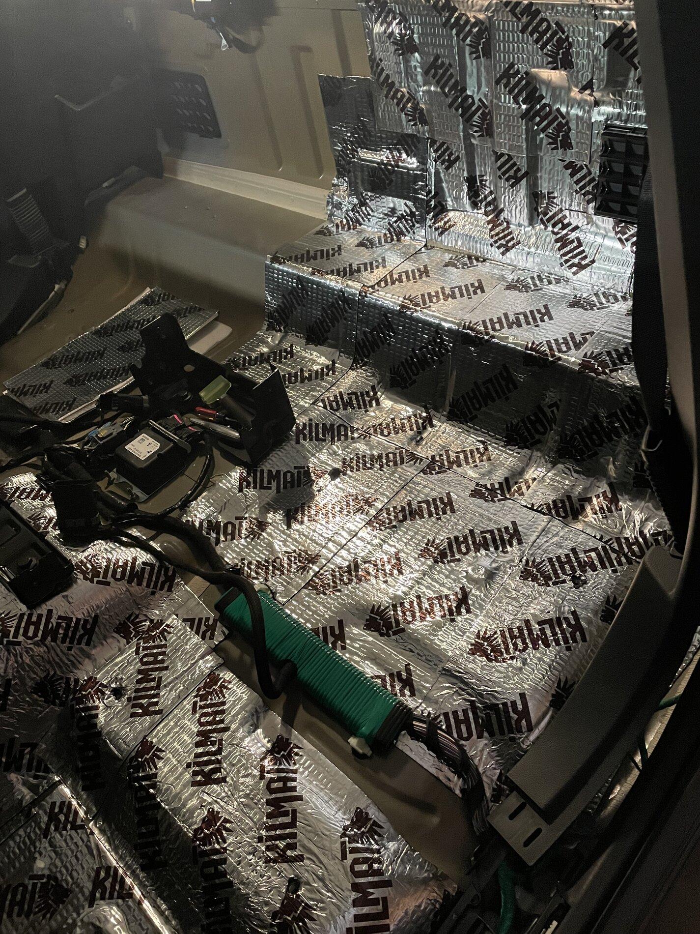

I have seen some sound deadening foil sheet on internet, post some pics and what you used, I will see as spring/summer project if this this getting in my nerves.
I only have one pic from the install, The Kilmat is pretty easy to work with however the Siless liner comes on a roll, is extremely sticky and once its down...it is down! I used Kilmat 80mil and then went over the top with Siless 157mil pe foam liner, bought both from Amazon. It did make a difference but it's not like night and day and maybe it would be a more noticeable difference in a super/crew cab?‍♀
