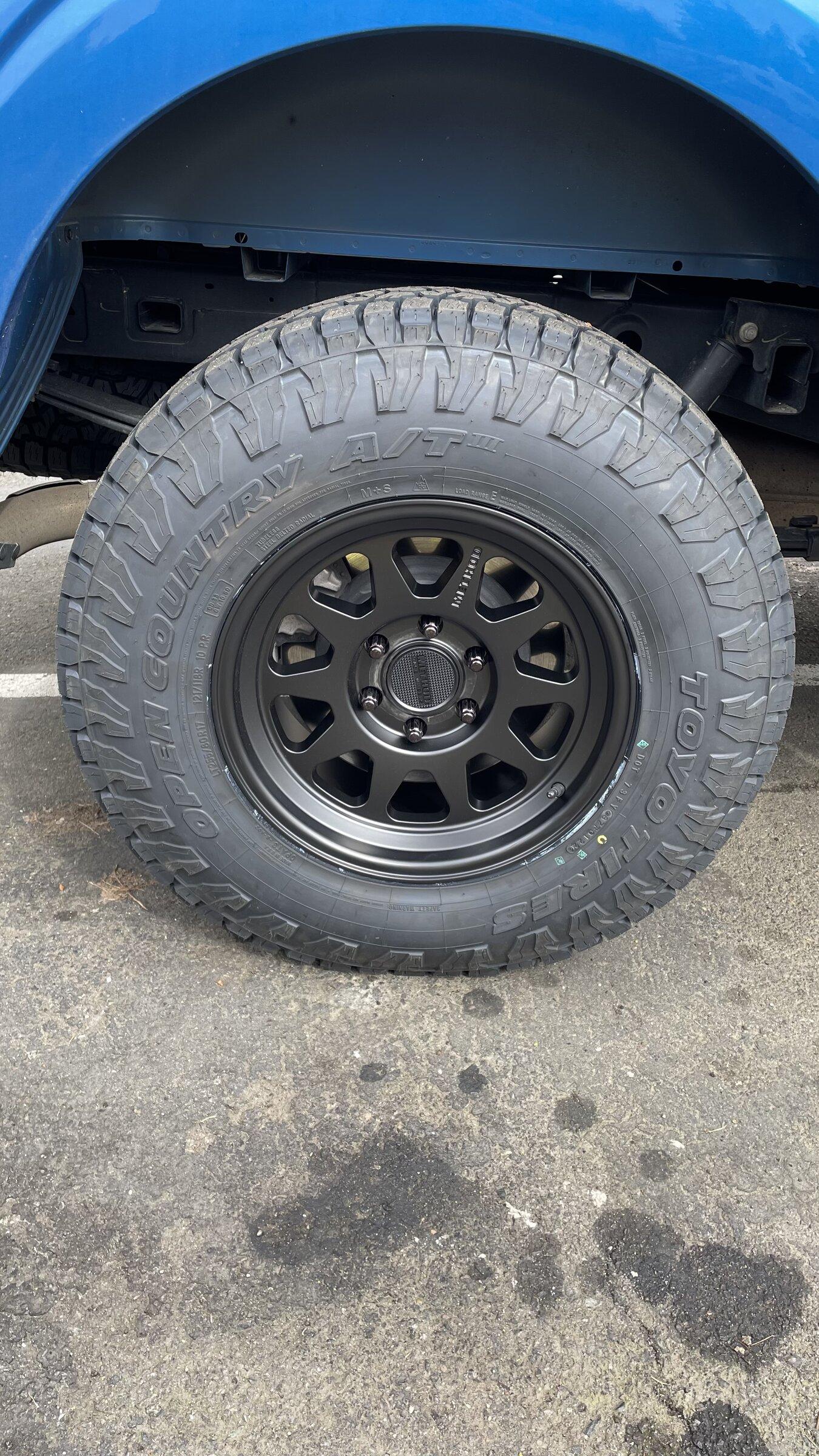

2021 F150 eb3.5 Scab Maxtow
Can confirm that Method 316 17” wheels with a 0mm offset fit over the larger 350mm rear rotors that come on the 2021 Max Tow package. Care needs to be taken with placement of balancing weights, but they do fit!
Ford F-150 rims that fit max tow? 10D8EE40-CFA7-43A8-A538-1F38196892C5
Ford F-150 rims that fit max tow? F482D134-0369-4447-8AE0-231AF792DB01
