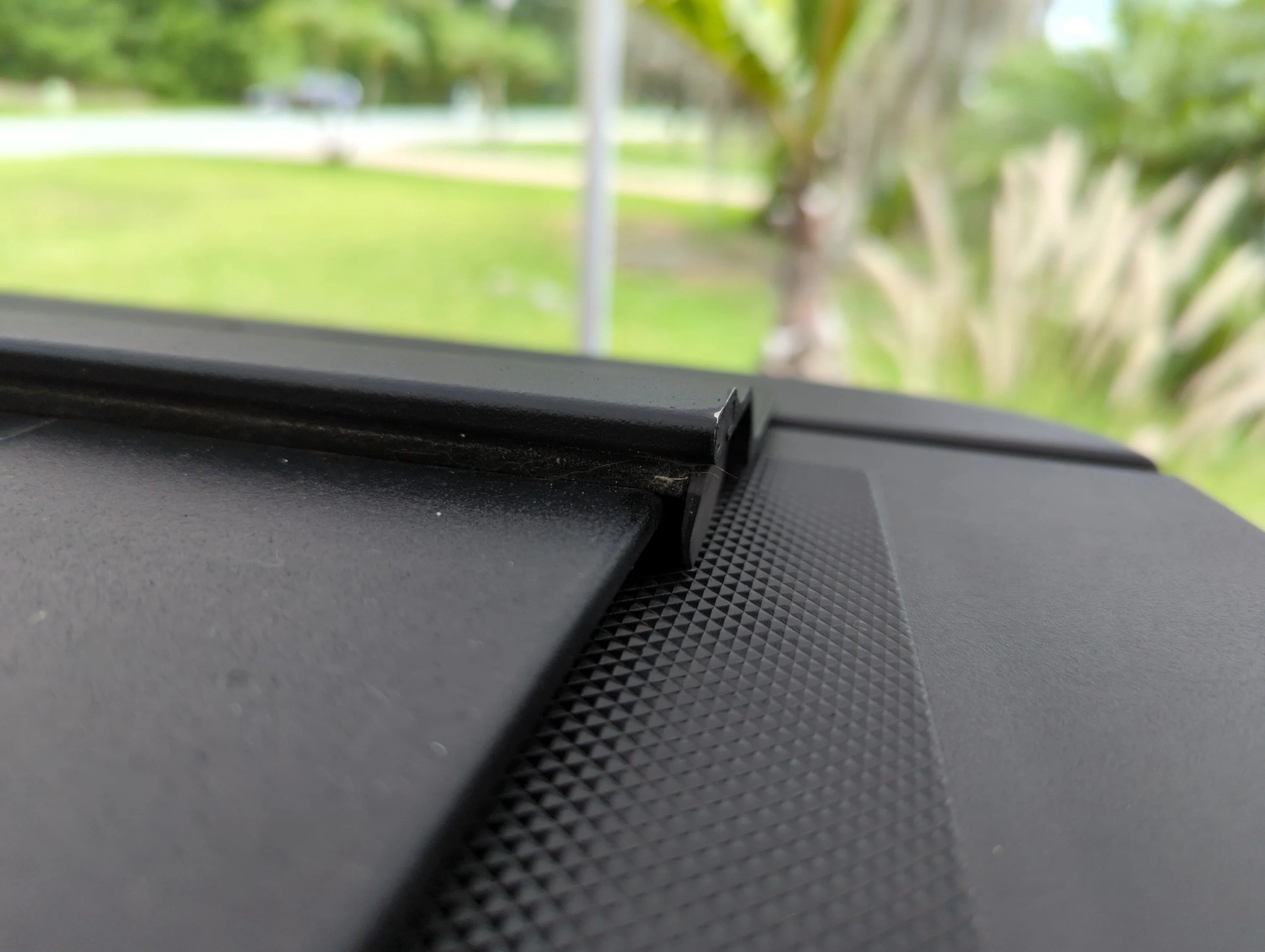

So I put my pro mx from my '17 on my '22 and here are some notes (which may not occur on a model made specifically for a '22 though they said my '17 would fit fine. I don't know if they are different models or not):
I'm getting water in at the tailgate. I have it aligned properly but I've also noticed that no matter how hard I try and adjust it and keep it square to the tailgate, the cover itself does not close as much on the passenger side than the driver side. Here is a pic. You can see the slat doesn't rest against the rubber seal. On the driver side it is. It's about 1/8" an inch.
Ford F-150 Retrax ProXR bed cover download_20220612_213019
I attribute this to the fact that you close it by pulling on the driver side. I've also noticed that it appears I don't have a great seal at the tailgate. It might have to do with the tailgate step? Not sure.
Second, I drove to get some new running boards and I had to use the "lock it anywhere along the length of the bed" feature. Well, it slipped back. When I got home, I was able to adjust the pins that lock against the rails, but I can see where it has left grooves in the rails. I can always buy new rails and mine are 5 years old. I've emailed them asking about it. If I do get new ones, I want to see if I can put the ones with t tracks on ?
Even with these 2 things I still love the cover and I would buy it again. I'm not overly concerned about keeping all the water out for my use case. Now that I know how it "locks", I will be more careful about what I keep in there and for how long. Not that the lock itself is great, but I bet if you pushed hard enough, you could push it open, even if it's locked.
