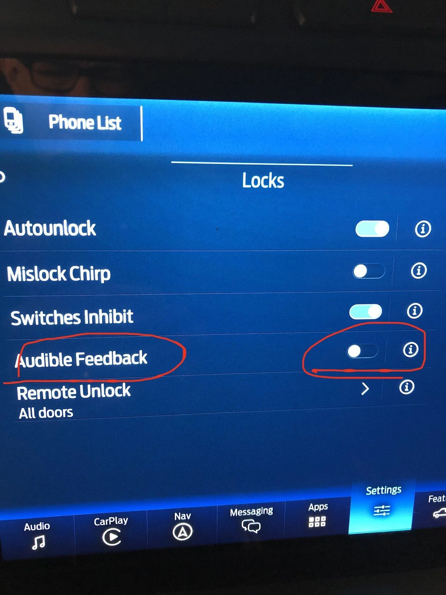

2021 F150 XLT - I may have inadvertently disabled the honk when pressing the lock button on key fob. Does anybody know what BCM address controls this function? I have the As Built data available. Thanks!

Press the button once, no honk. Press the button twice, honks.

By pressing the key fob twice, is use for locating your truck. With the Lariat 502A High, press once to lock and sets alarm, twice to locate your truck. You can just press the button on the driver side door handle to lock, touch back side of door handle unlock truck, providing you have key fob on you.

Thanks Jeff, that is what I was looking for. Mine matches "As Built 0101 0101 0057" but still no horn when pressing lock 2 times.
Shouldn’t 0057 be 0157?

No, 726-24-02 is 0057. Cut and paste from As Built

Resolved - The audible feedback in "Locks" setting was turned off. Not sure how this happened. Could it have been turned off by an OTA update? Anyhow, it's working now. Thanks
