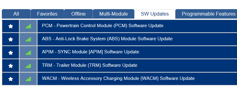

Ok, I did see that the update finally installed yesterday, don't know if it is because of the rural area I live in or servers being busy or something with the truck.
They say it is a bad camera, but the camera works fine, I just don't have the option for the bed camera (when moving). A friend that has an 2021 XLT built a month before mine has the option and it works fine.
Thanks for checking!
The option to view that camera at speed is disabled in your IPMA. Replacing the camera will not fix that.
Ford F-150 Request VIN Lookup Thread 1765401778277-wr
If all you care about is the bed camera at speed, make this change with FORScan:
xxx2 xxxx xx--
If you want all cameras that can work at speed to work at speed, change it to an F instead of a 2.

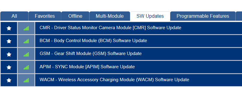

So I live in a Mac world, but someone gave me an old win laptop, so finally was able to get FORScan to work and I did enable cameras at speed and it works, but this is what my friend that has the 2001 XLT (built a month before my 2021 Lariat) sees.
