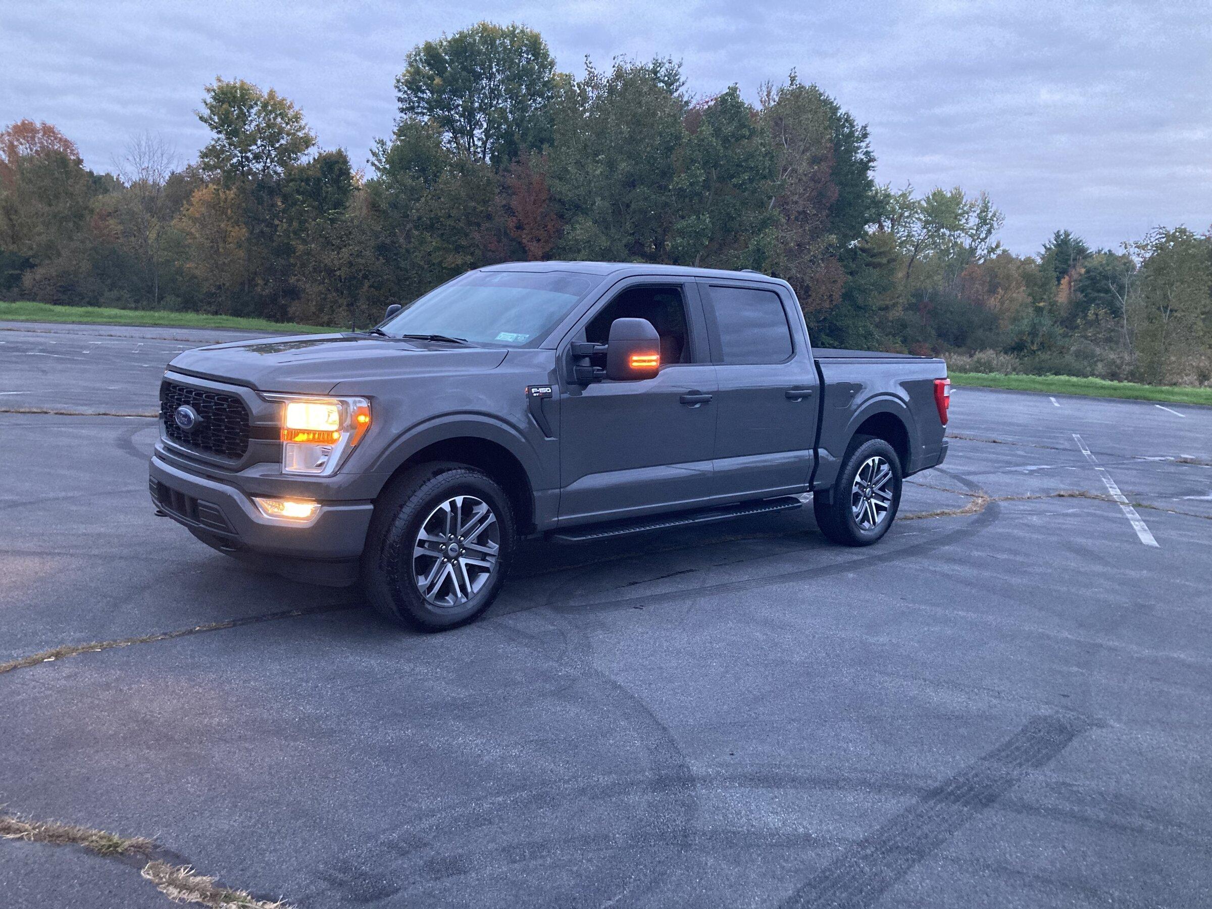

Yes, after removing the blocks you are pretty much level. Buy a ratcheting 13/16 end wrench, I've yet to find a deep well that can put the nuts back on after removing the block. You can do it with a regular end wrench, but it takes 4x the time.
