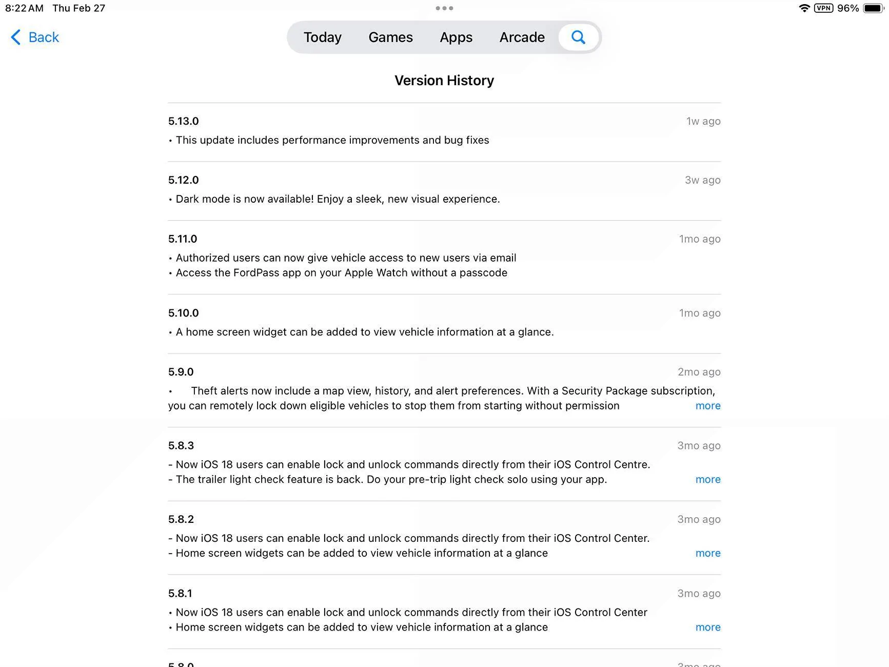

5.14 is out.
Maybe it'll address you fellas remote start issues?

Updated to 5.13 yesterday as this is the latest Canadian version on the App Store.

5.14 is out and I just got 5.13 last Monday...I see Ford is quick in getting updates out...lol
Interesting, Not on the App Store listing that‘s for iOS. Strange for an Android release before IOS .
