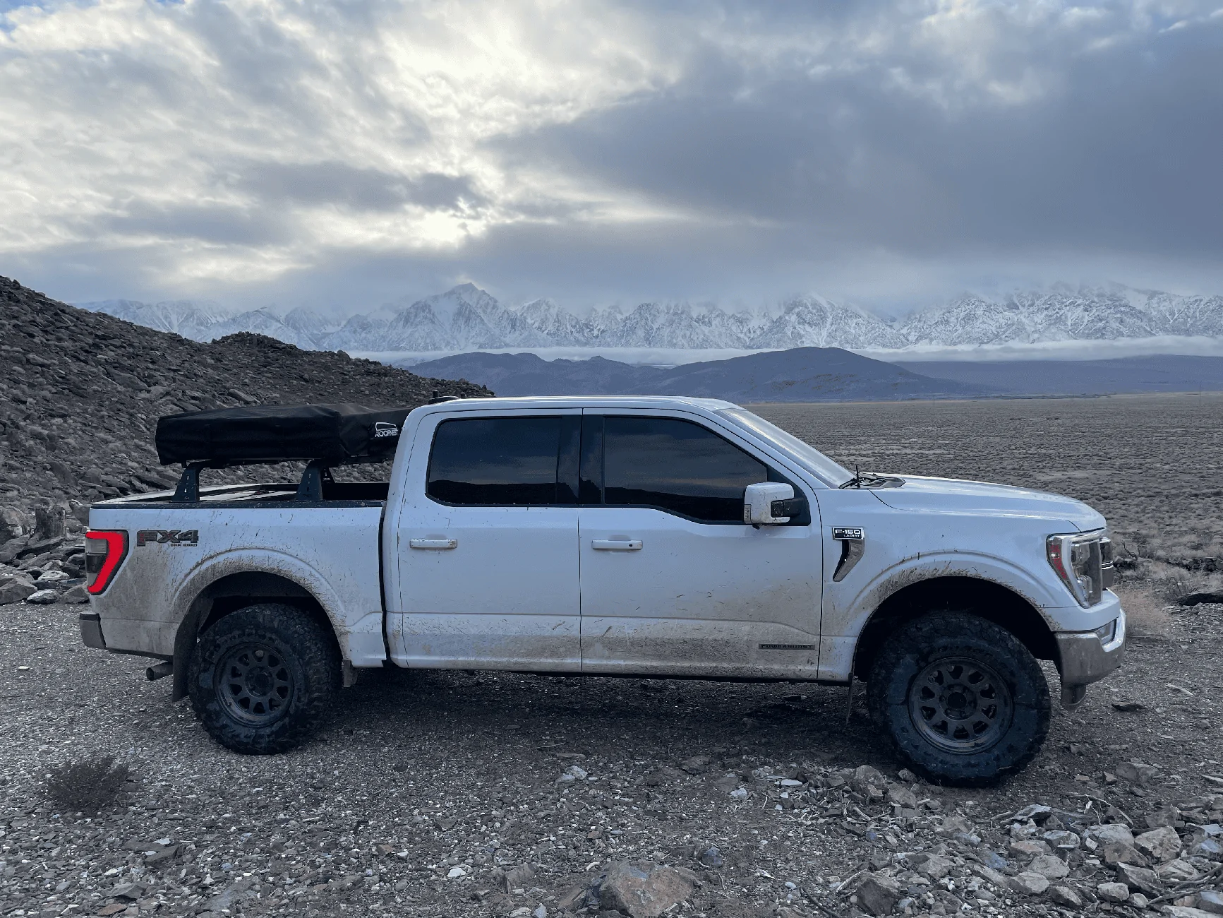

Your set up is clean and simple, really like this. What made you get the bars instead of the rack from RCI ?
Cheaper, lighter, easier to remove and store. I only mount them up for camping trips. Very happy with the setup
