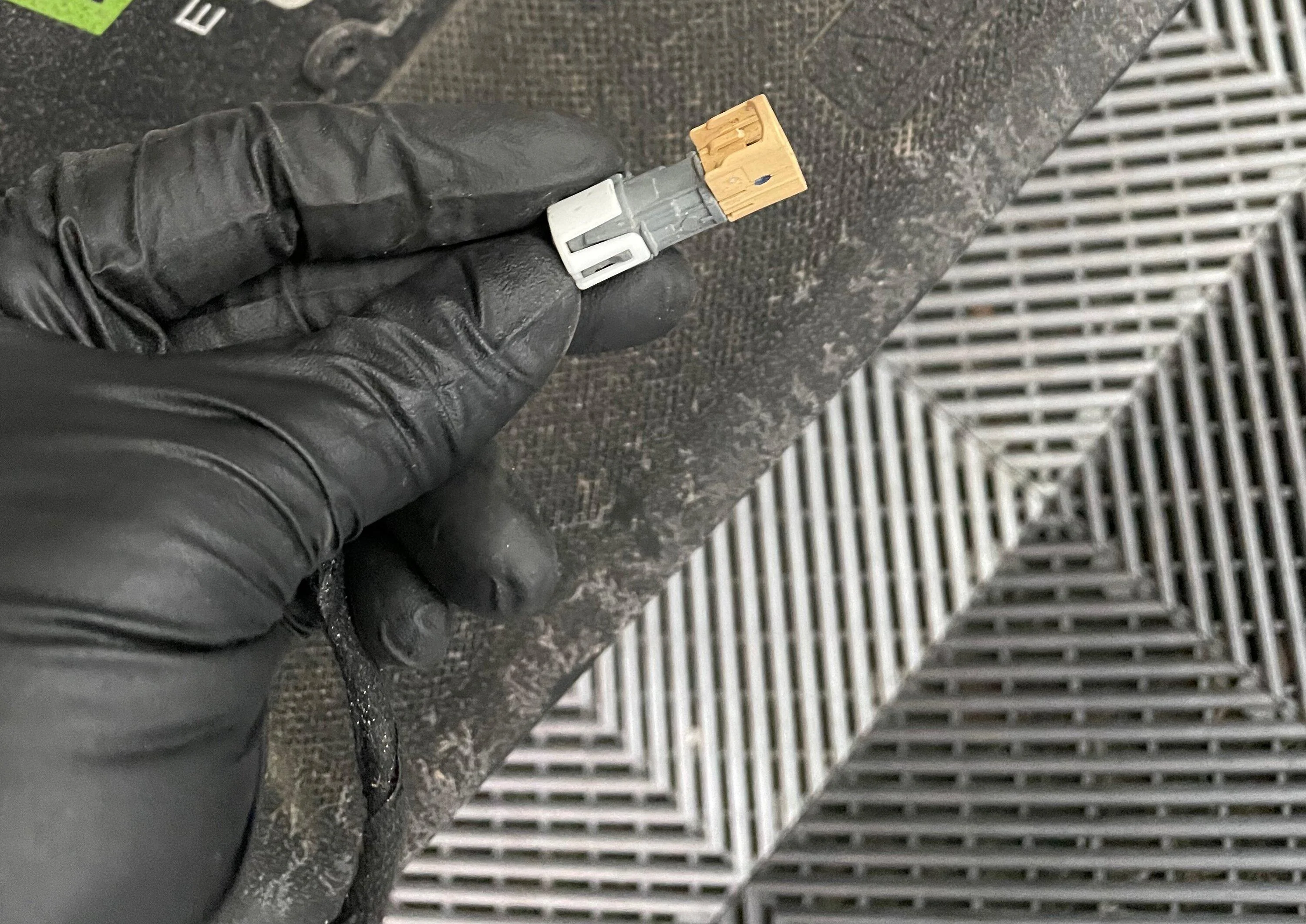

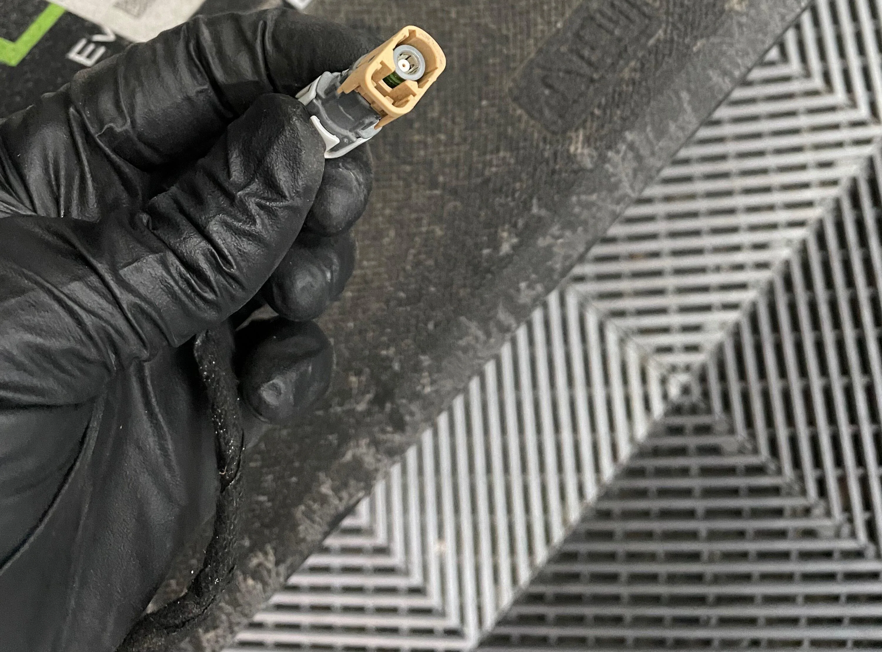

Is this part of the tailgate plug / rear view camera replaceable?
I took my tailgate off today and the tab snapped on the camera cable.
Can I just replace the tan color female piece? It looks like that should be possible.
Ford F-150 Rear View Camera Plug Broke IMG_2600
Ford F-150 Rear View Camera Plug Broke IMG_2599
Ford F-150 Rear View Camera Plug Broke IMG_2601

I havent found it to be sold separately. You would have to replace the tailgate harness. I htink I have one though form all my changes I have made.. Ill look tomorrow and see.

Did you happen to find one?

Ford sells a mini harness that is expensive but far cheaper than the ones for GM trucks that cost over $700. I wanted to add a second receptacle for a second rear camera on my Silverado and decided that price for the harness was more than I wanted to pay.
