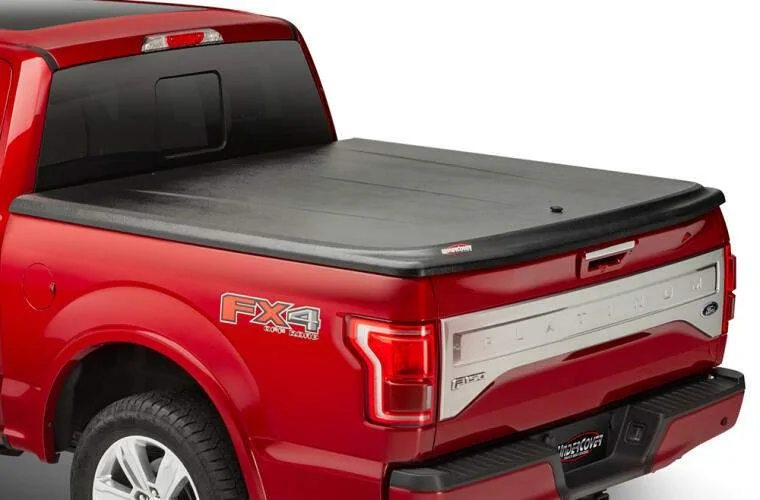

That’s not my truck. It’s a stock image of the tonneau.
