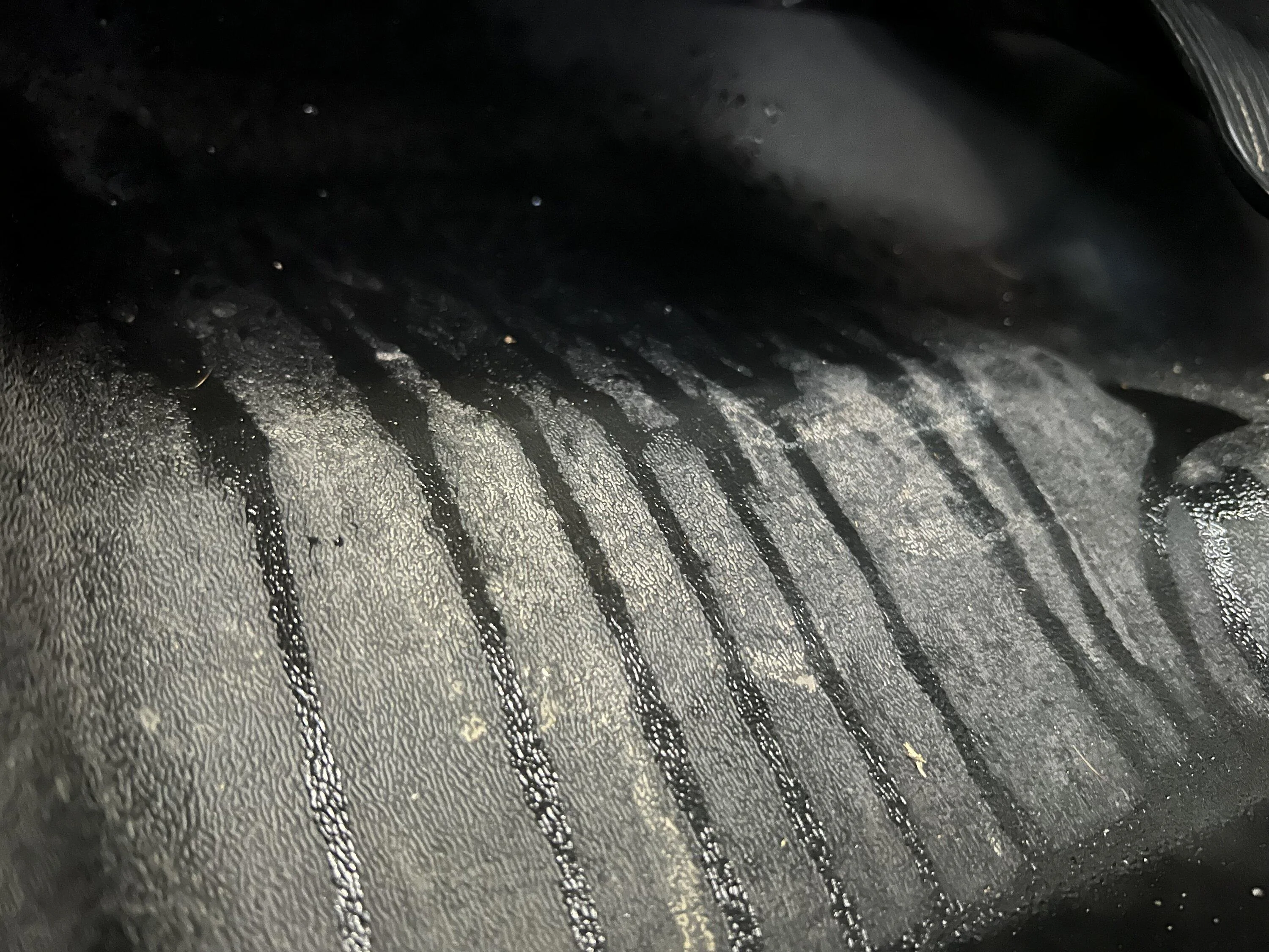

Has anyone experienced rain leaking in through the firewall and pooling on the floor on both the driver and passenger side? I bought my 2021 in July of that year, only recently have I experienced this. Leaving work after a rain the floor mats had a good half pint of water sitting on them and you could see where it was trickling down up behind the pedals, I took it in to my local dealership but they couldn't duplicate this issue with a pressure washer.
Ford F-150 Rain Leaking Through the Firewall?? IMG_0067[1]

Could the AC drain tube be plugged or has come off?

There was a windshield recall on some of the ‘21s. Not enough sealant if I remember correctly. Might not hurt to check that you have no recalls outstanding.

That was one of the first thoughts that I had, the only outstanding recall I have is for the windshield wiper motor.
No, no issues with the AC, I only see this after it has been sitting out in the rain. I keep it garaged but when I'm at work I'm at the mercy of mother nature.
