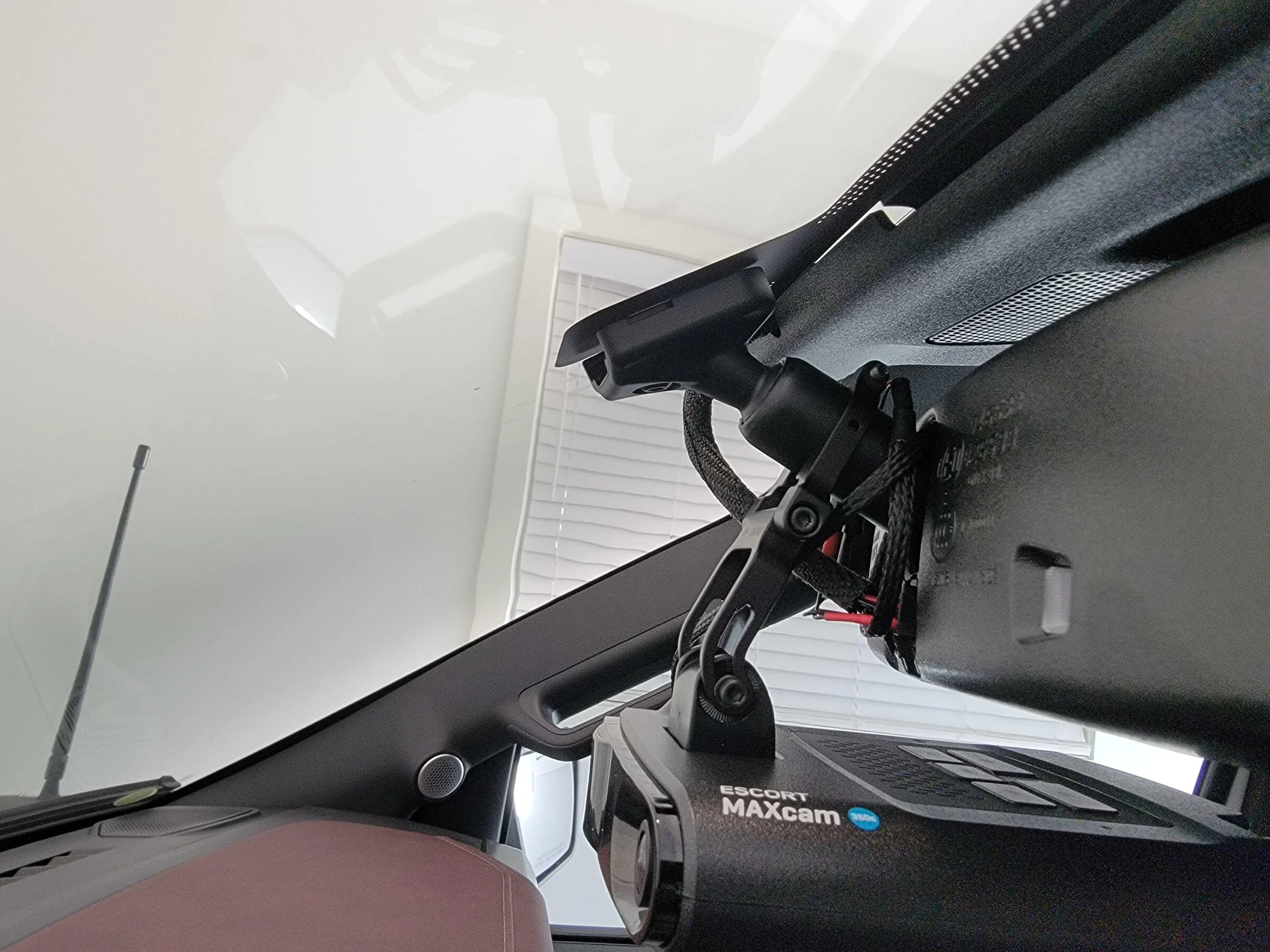

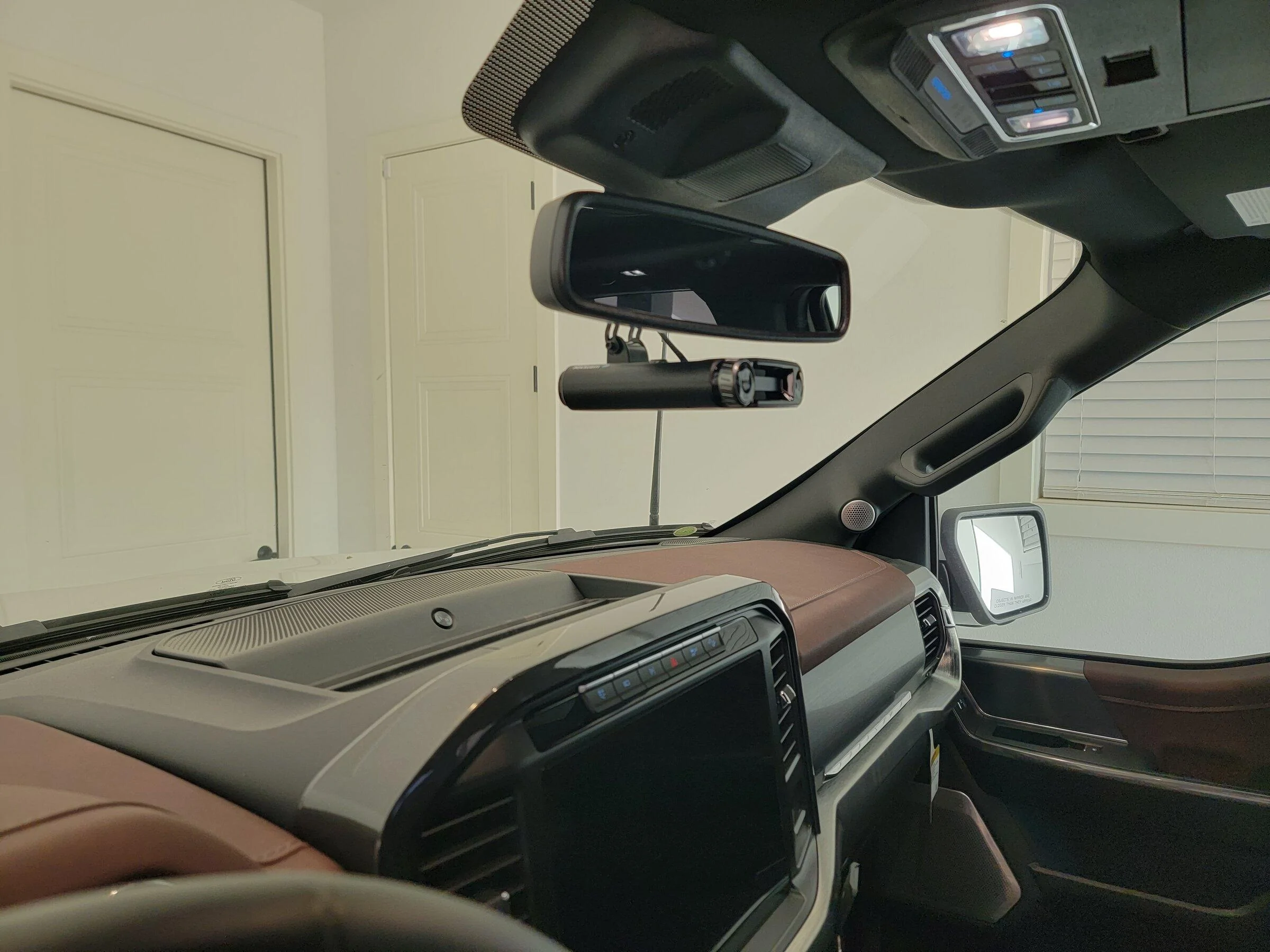

Mounted my new Escort Maxcam 360c and also hardwired it to the rear view mirror.
2021 Lariat mirror wiring -
Green wire = power
Black wire = ground
Blend Mount BMG-2001G
Ford F-150 Radar Detector 20211230_163206
Ford F-150 Radar Detector 20211230_163218
Ford F-150 Radar Detector 20211230_163350

I like that mount. I have my Escort Max360C hardwired much like yours. However, I have the suction cup that will occasionally fall down during high/low temp combinations.

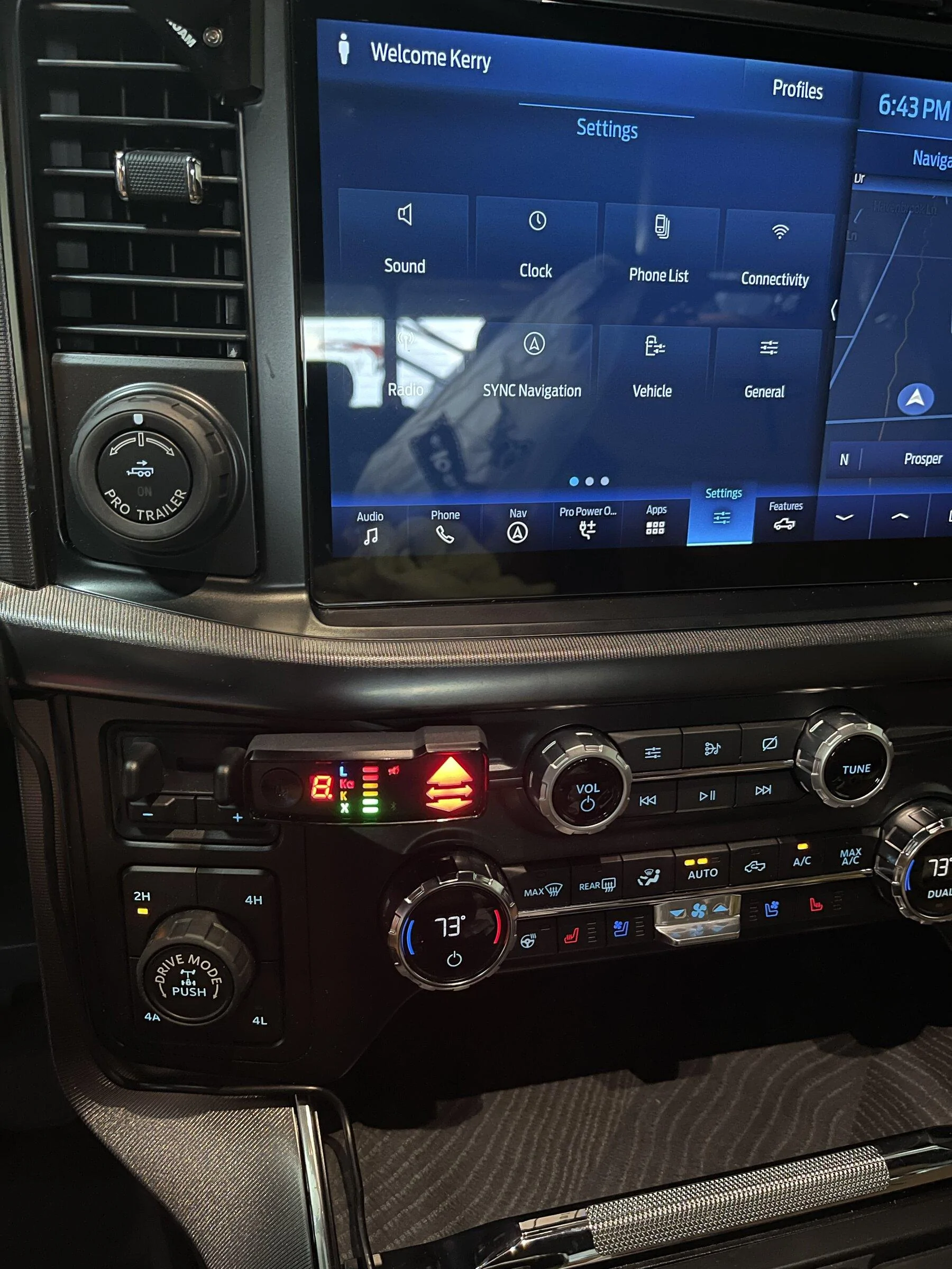

I mounted my V1 high on the windshield and mounted a remote display/mute here…
Ford F-150 Radar Detector 4F192CF0-0509-4F17-BDEB-843BCAE58871

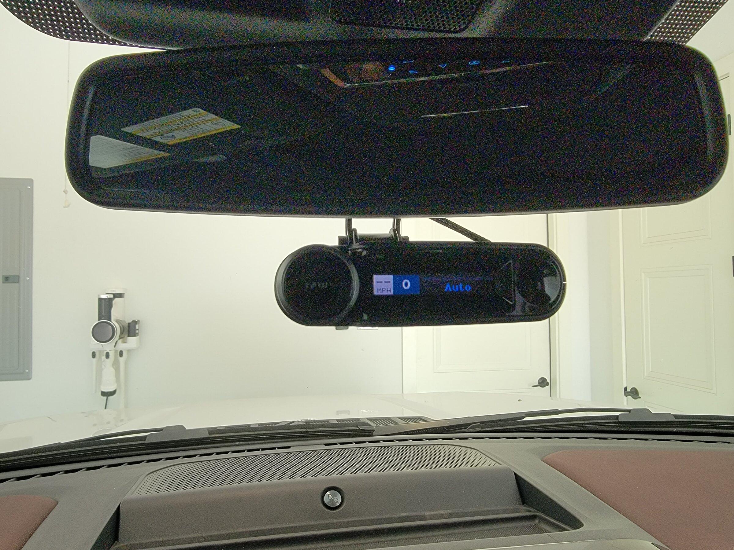

Does anyone know of a mount similar to Blendmount but locate the rd to one side of the mirror as shown in the picture instead of below? I tried the Blendmount but it blocked too much of the view based on the mounting height needed for the mag mount detach to have enough clearance.
Ford F-150 Radar Detector 9102D049-1972-42F0-A414-6E26C6E25887

Thanks for saving me a few minutes on hunting of the power wire. Additionally, your photo confirms that my existing blend mount for my 9500ix will work for the Lariat rear view mirror, and I don't have to order a different piece for that!
